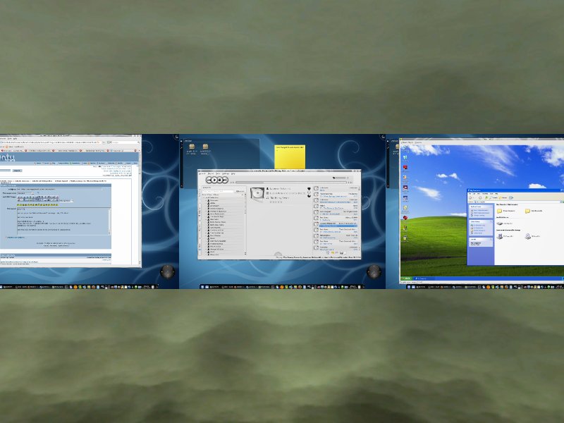

What Just Happened to My Installation?
    Re: What Just Happened to My Installation?
    Originally posted by dibl
    Originally posted by leeraconteur
    wake up.
    I have an update notification.
    "You have 21 updates"
    I install through adept.
    I ctrl-alt-backspace.
    What do I see? All of my wallpaper, my compiz, my plasmoids, all the graphic interfaces that ARE THE REASON WHY I CHOSE 8.10, they are all GONE and I am staring at a plain jane, none 3d interface with the off tan theme from Ubuntu 6.10 .
    But, Ubuntu 6.10? Do you mean "looks like" or "actually is"? I have no clue how one would get a 6.10 splash onto a 8.10 system -- I think it would be a tricky maneuver, at best.
    Screenshot:
    [img width=400 height=250]http://i35.tinypic.com/2zggjnq.png[/img]
    Full size image link:
      That's Gnome! You evidently have got it on your system somehow, and it's logging you into that rather than KDE.
      Now we know what the problem is, it should be an easy fix, though I'm not sure how myself.
