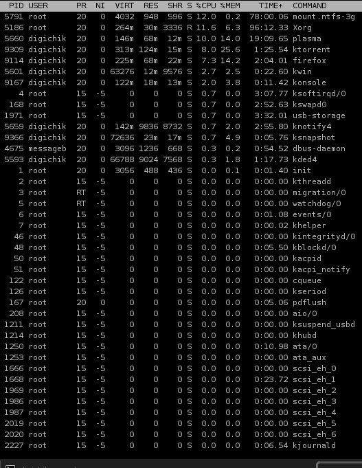

                          ok, i check on the konsole, and I type top and this is what it give me

                              I see that you're running bittorrent at the same time. Do you have torrents uploading? Your perceived network performance with, say, firefox, is affected by the network activity of your other processes.
                              Specially with ADSL connections, which don't have symmetric bandwidth, it is easy to saturate the upstream bandwidth with torrent activity. The net effect is that firefox can take a long time to request something to a server. This is very easy to test, just open the system monitor and check the network upstream bandwidth. If it is close to 80% of your upstream bandwidth without opening firefox you have found the solution for your problem. Simply go to your torrent software and limit the maximum upstream bandwidth that it can use.
