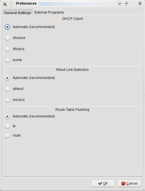

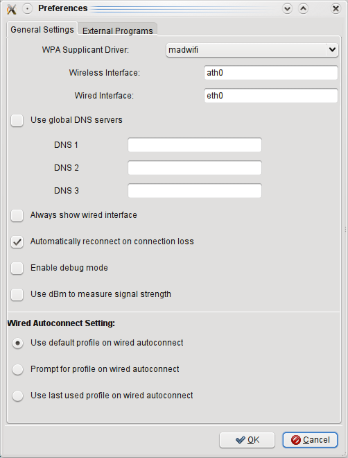

      Here go some screenshots of my config, hope they help you!

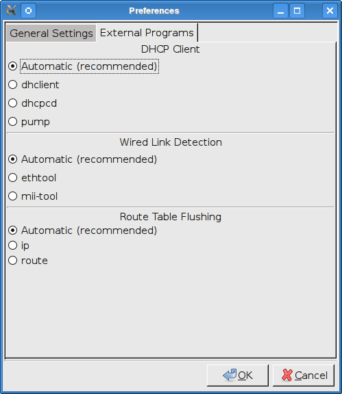

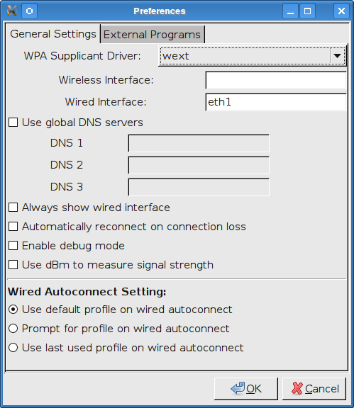

        Hmmm.... I only have two setup screens, not three:

          Actually, my first screenshot is the main window, I wonder if wicd gets confused because you have two devices? (wireless and wired). Have you tried clicking on "Wired Network" in the main window and make it the "default profile" as in my screenshot?

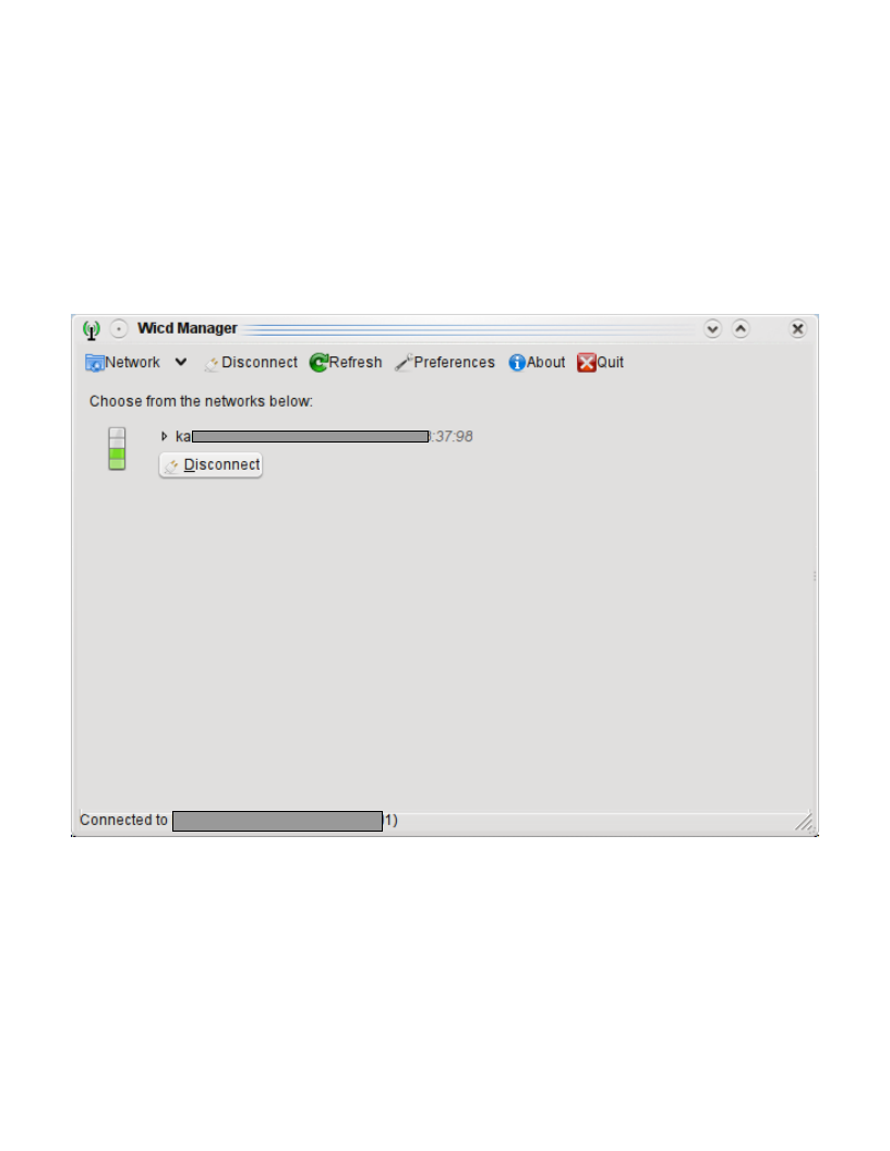

                I don't have that option. Here is my main WICD screen after I click the "Connect" button. Before clicking "Connect" it only shows my wireless.

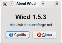

                    I'm running Kubuntu 8.10 - KDE 4.1.3. The "About" of WICD doesn't show the KDE version.... only the WICD version:
                      Re: [SOLVED] KNetworkManager and global configuration: try WICD!
                      Hmm. Wicd 1.5.3. Doing searches on Google finds that Wicd is currently at version 1.5.4 (stable) on SourceForge.net. It can be downloaded here. I'd download the wicd_1.5.4_all.deb file to your desktop. You need only double-click it to install.

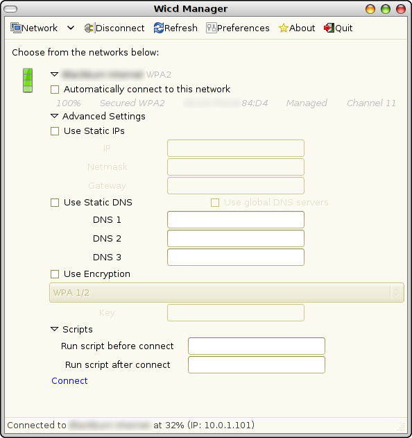

                        this may be a stupid question...have you clicked the triangle next to your wireless connection, to 'expand' it, then clicked on advanced?

                          Well, it wasn't a stupid question.... it was a good one! I hadn't even noticed that little, teeny, weeny triangle. I clicked it and whaddaya know?... there was the button for "Automatically connect to this network".
                          I guess I'm a couple of clicks above "DUH"
