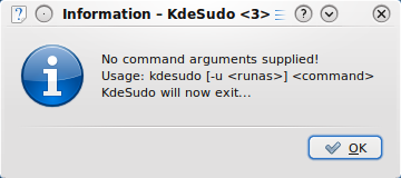

            Re: cannot update or install using KpackageKit
            the same problem here , but i use the terminal :
            sudo aptitude update && sudo aptitude dist-upgrade
            when i update with KpackageKit give me this problem :
            Error Type:
            Error Value: "The cache has no package named 'dpkg-exec'"
            File : /usr/share/PackageKit/helpers/apt/aptBackend.py, line 1948, in
            main()
            File : /usr/share/PackageKit/helpers/apt/aptBackend.py, line 1945, in main
            run(args, options.single)
            File : /usr/share/PackageKit/helpers/apt/aptBackend.py, line 1907, in run
            backend.dispatcher(args)
            File : /usr/lib/python2.6/dist-packages/packagekit/backend.py, line 647, in dispatcher
            self.dispatch_command(args[0], args[1:])
            File : /usr/lib/python2.6/dist-packages/packagekit/backend.py, line 611, in dispatch_command
            self.update_packages(package_ids)
            File : /usr/share/PackageKit/helpers/apt/aptBackend.py, line 166, in _unlock_cache_afterwards
            func(*args, **kwargs)
            File : /usr/share/PackageKit/helpers/apt/aptBackend.py, line 1095, in update_packages
            if not self._commit_changes(): return False
            File : /usr/share/PackageKit/helpers/apt/aptBackend.py, line 1620, in _commit_changes
            PackageKitInstallProgress(self, install_range))
            File : /usr/lib/python2.6/dist-packages/apt/cache.py, line 314, in commit
            res = self.installArchives(pm, installProgress)
            File : /usr/lib/python2.6/dist-packages/apt/cache.py, line 289, in installArchives
            res = installProgress.run(pm)
            File : /usr/lib/python2.6/dist-packages/apt/progress/__init__.py, line 329, in run
            res = self.waitChild()
            File : /usr/lib/python2.6/dist-packages/apt/progress/__init__.py, line 298, in waitChild
            self.updateInterface()
            File : /usr/share/PackageKit/helpers/apt/aptBackend.py, line 398, in updateInterface
            apt.progress.InstallProgress.updateInterface(self)
            File : /usr/lib/python2.6/dist-packages/apt/progress/__init__.py, line 277, in updateInterface
            status_str.strip())
            File : /usr/share/PackageKit/helpers/apt/aptBackend.py, line 372, in statusChange
            pkg = self._backend._cache[pkg_name]
            File : /usr/lib/python2.6/dist-packages/apt/cache.py, line 142, in __getitem__
            raise KeyError('The cache has no package named $r' $ key)
            also when i start my pc i have a problem with gksudo check the pic
            i hope this help ..
