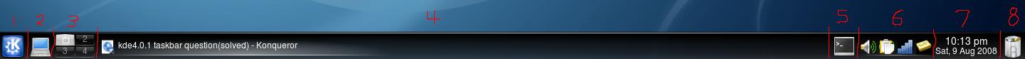

                          When you don't see a - on the widget (Task Manager) it means that it is not installed. So, clicking it and adding it puts it on the panel. You won't "see" this happen. Close the Add Widgets window and open a program and minimize it. The application icon should appear on the panel. The snapshot below shows Three running applications - Konqueror, Konsole, and Gimp, of which Konsole and Gimp are 'minimized.'

                              In the screen shot below, I've identified how my panel is organized.
                              By the numbers:
                              1 - this is the Application Launcher widget.
                              2 - this is the New Device Notifier widget.
                              3 - this is the Pager widget.
                              4 - this is the Task Manager widget.
                              5 - this is a Konsole icon added to the Panel by K Menu > Applications > System > right-click on Terminal > Add to Panel
                              6 - this is the System Tray widget.
                              7 - this is Digital Clock widget.
                              8 - this is the Trashcan widget.
