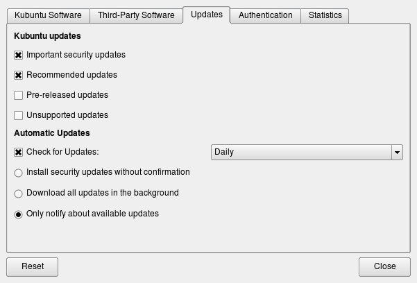

I've had a few updates in the last few days. I assume from Adept menu under Adept >> Manage Repositories >> Updates >> that the Check for Updates are properly set, as well as notification. Might be you have it set to automatic install ?

Rusticdog I tried doing what you suggested but Adept >> Manage Repositories is as far as I can go. I see no options anywhere for setting up autmatic updates.

I have the similar problem as above, adept-notifier popping up it's green 'nothing to install' bubble at startup, despite there are updates available manually (just then the warning triangle pops up in the system tray). Daily update notification is checked in manage repositories, I'm on a IBM T61 wtth Nvidia graphics, Kubuntu Hardy and Compiz.
