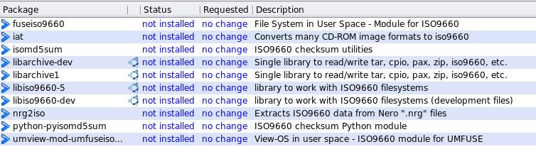

        According to the article
        If any of the drivers you thought you compiled in are not displayed, then something went wrong with the kernel configuration or build. Start the installation process again, beginning with configuration and building of the kernel.
        My build seems otherwise OK, do I really need to reinstall (plus the fact I wouldn't know how to go about it - beyond starting all over again)?
        I had a look in Adept and searched 'iso9660', neither libarchive1 or libiso9660-5 are installed
        Should I install one of these libs and that would add the iso9660 driver?

          I checked my installed packages and find the libiso9660-7 (I'm running a newer kernel). I think you need to install that one (the -5 shown on your list).
          Another thought -- make sure your user is a member of the "audio" group and also the "fuse" group, and then you'll have to log out and back in to see if makes a difference.
            Re: CD/DVD Drive either not mounting or just not seen on Acer 4810t
            Done
