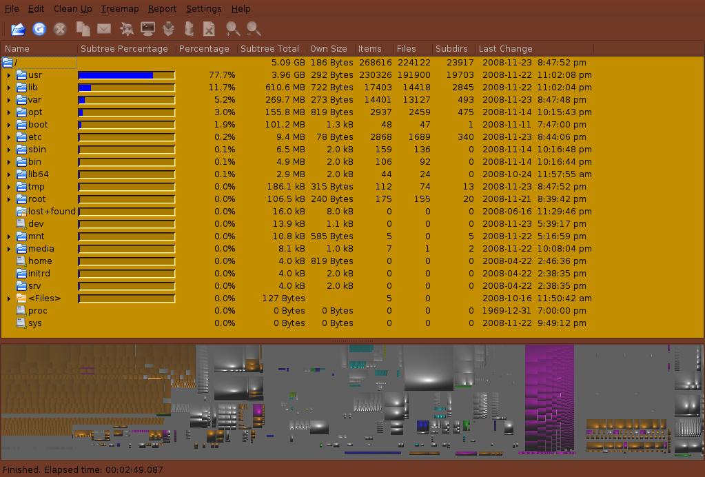

                  I'm wondering why Kdirstat doesn't show 19 gb of files though I think what ever is hogging 14 gb there it's not a regular file. Look at this screen cap and do the math

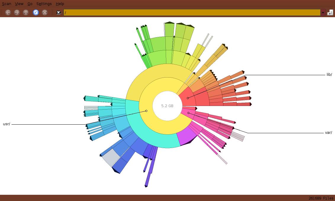

                    Re: Something gobbled root
                    I've got to question which drive you are looking at. Your initial report:
                    ka9qlq@dittohead:~$ df -hTxtmpfs
                    Filesystem Type Size Used Avail Use% Mounted on
                    /dev/sdb1 ext3 20G 19G 568M 98% /
                    /dev/sdb2 ext3 48G 30G 16G 66% /home
                    /dev/sda5 ext3 147G 129M 140G 1% /mnt/storage1
                    /dev/sdc5 ext3 145G 129M 139G 1% /mnt/storage2
                    /dev/sdb3 ext3 6.4G 143M 6.0G 3% /mnt/sdb3
                    /dev/sdd2 ext3 905G 324G 536G 38% /mnt/sdd2
                    Shows a 20G root partition on sdb1 (2nd HD, 2nd partition). But your screen shot identifies a 5.09G root partition. Can you explain?
                      sdb1 is / or root [long story but it's correct] and running Kdirstat shows 5.09 gb of files on it I don't think it lists free space
