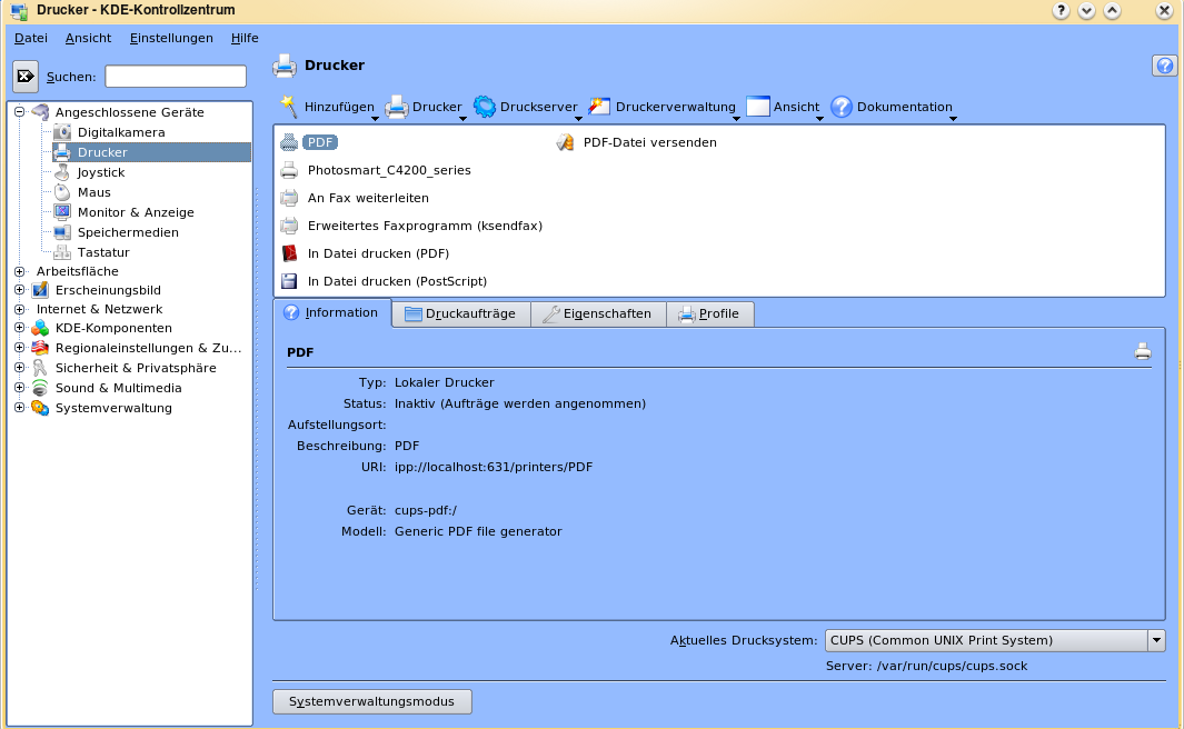

                In kcontrol you should have printer in connected devices (or something like that, mine is in german and I don't know what the french version would be).
                Click on that and you will see a printer window where you can add a printer.
                This is what it should look like:

                  Fredh, thanks for your reply.
                  Well, a bit is missing on my computer : I do have the "devices" section, but no "printers" subsection. Only "keyboard", "joystick", "mouse" and "Storage devices" ... :
