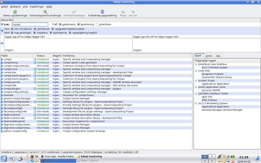

          Hi
          Snowhog:
          The following packages are missing:
          compizconfig-backend-gconf
          compizconfig-backend-kconfig
          desktop-effects-kde
          But I have
          libcompizconfig-backend-gconf
          and
          libcompizconfig-backend-kconfig
          installed. I don't know the diffrence. Where do I find the first three (for download?)?

            K Menu > System > Adept Manager
            Type in your password when prompted. Search for each package and click the blue > next to the package name and click the Request Install button. Once you have the packages marked for installation, click on Apply Changes on the menu bar.
              Re: Installed Comiz-Fusion is not working
              Yes
              But the packages don't exist in Adept Manager.
              Can't find them there.
              It's just those tree, the rest is installed and ready.
                Open Adept Manger and click on Manage Repositories. Ensure that both the universe and multiverse repositories are checked. If either or both are unchecked, then when you check them and close the window, Adept Manager should automatically update itself. If it does not, click on Fetch Updates. Check for the packages afterwards.
                  Nope sorry all four of them is checked.
                  Tryed to change the server that Adept gets the packeges from, no change.
