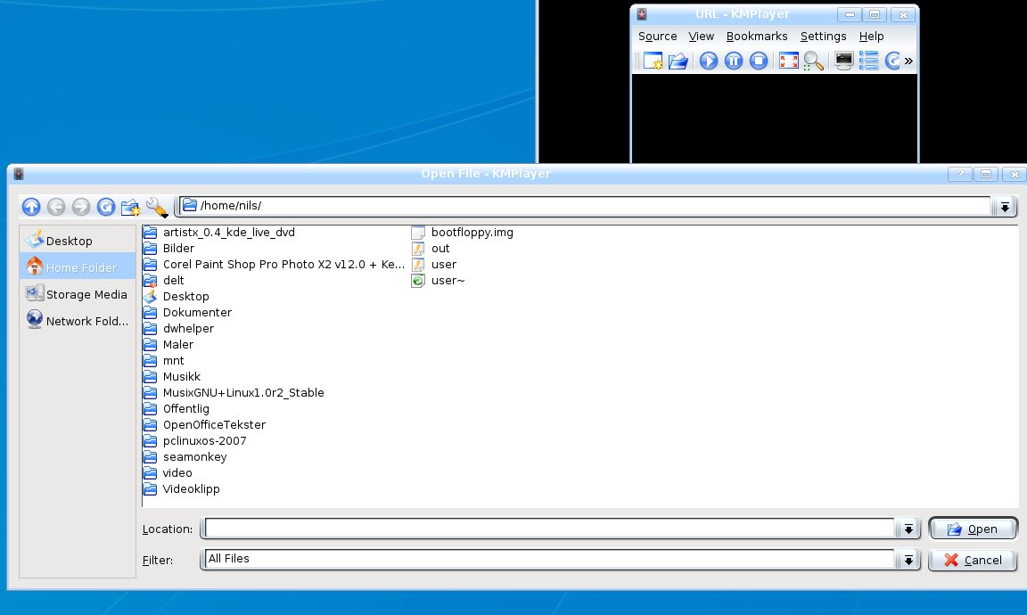

            Yup, that's what it should look like. On mine, I click Open, Play URL.
              Re: KMPlayer - TV
              When I do that, here is what I get - see attached snapshot
              EDIT: Wrong snapshot - correct at the bottom.
                Re: KMPlayer - TV
                Sorry, I don't know what else to tell you. That is how it works on mine.
