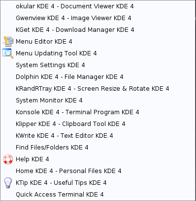

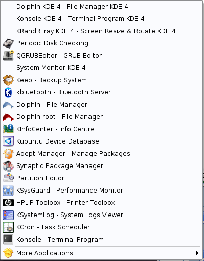

    Here KDE 4 rc2 installation is messing KDE 3.5.8 menus and file associations. So "Application Preference Order" for .txt-files is now KWrite KDE 4, Kate, KWrite. And in the K Menus:
          I assume the kmenu items are there by design, so that one can run/test kde4 apps in a kde3 session easily...does add a bit of clutter though. Not so sure about application preference, that seems like a 'bug'.
          From http://kubuntu.org/announcements/kde4-rc2.php:
          KDE 4 apps should appear in your KDE 3 K-menu or you can run a full session by selecting "KDE 4" from your login manager.
            Re: KDE4 rc2
            Yes, Dolphin KDE 4 is trying to start with (in the KDE3.5.8 ) dolphin %i -caption "%c"-kde4. I think, that it should be dolphin-kde4 %i -caption "%c"
            Hmm :
            okular %U %i -caption "%c"-kde4 -> okular-kde4 %U %i -caption "%c"
            gwenview %u -caption "%c" %i-kde4 -> gwenview-kde4 %u -caption "%c" %i
            kget -caption "%c" %i-kde4 -> kget-kde4 -caption "%c" %i
            systemsettings -caption "%c" %i-kde4 -> systemsettings-kde4 -caption "%c" %i

            Cleaning (all KDE 4 apps in the same submenu):
