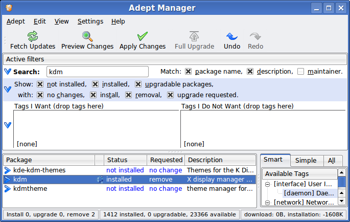

                          Guys, here is the experiment. In Adept:
                          • 1. Select "kdm" for removal.
                          • 2. No pop-up, nothing, and in the status line it reads "remove 2" (go find this).

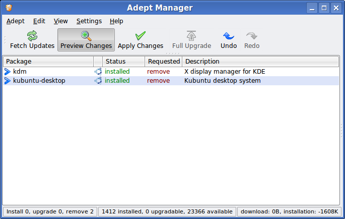

                          • 3. Do "Preview Changes " (the user doesn't necessarily do this).
                          • 4. "kubuntu-desktop" is listed for removal. Again, the user should need to do that this will totally screw her/his installation. This is a meta-package that include hundreds if not thousdands of packages.
                          I think this is pretty conclusive ...

                            KDM is the K Desktop Manager! Of course that's going to nuke your entire Kubuntu system! That's not a bug!
                            I thought we were talking about a bug related to removing alsa? :P
                            Adept Manager and/or Synaptic are GUI front-ends to the Debian Package (dpkg) system -- a database of installed applications on your Debian Linux system. Adept and/or Synaptic don't know whether you are happily running a Gnome desktop (GDM) or a K Desktop (KDM), or both. Whatever you want to add or remove, they will be happy to do it. Maybe you want to change from KDE to Gnome -- how would you do that? YES, by removing the kubuntu-desktop meta package, of which kdm is a critical component. So it's not a bug that Adept Manager is willing to oblige your request.
