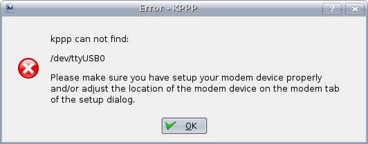

                I have been using my phone as modem on windows for monthes now on this laptop.
                The step that I get hung up on is after I go thru setting up the modem to use ttyusb0 - whatever, then try to connect I get a msg stating no dial tone detected. and it stops
                and now I get the msg on the screen shot

                  If you query the modem do you get any response back?
                  In KPPP, click configure > select the modem tab > select the modem > click edit > click the modem tab > click query modem
                  This tab also has a check box to not wait for a dial tone before dialing.
                  If you don't get a response back when you query the modem...
                  What was the text of the line that you added to the /etc/modules file?
                  Were you able to find the vendor and device codes for your phone?
                  I'm wondering if the USB serial driver loaded properly. It should have set it up as that device, but I suppose it is possible that it's at a different location.

                    Re: KRZR as Dial out Modem
                    One other thing to check...
                    With the phone connected, open up the K menu > System > Kinfocenter
                    Click on the devices item in the list on the left. Look through the devices that appear on the right and see if one of those looks like it might be your modem. It would let you know what to use instead of /dev/ttyUSB0
