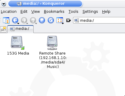

            My project on this subject was to find a method that would fully use the KDE interface and minimize the need for editing system files. In other words: click only.
            I ended up re-formatting and re-installing Gutsy just to see how it works from scratch. The setup was a "server" which had large capacity drives and was also connected to a printer and a "client" which is my laptop. The intent was to share files/directories from the sever as well as the printer.
            Sharing Files:
            Server Side:
            1. Install Package "nfs-kernel-server" with Adept. This also installs all dependencies including portmap
            2. K-Menu>System Settings>Sharing. Go to "File Sharing" and click "Administrator mode". Enter your password and then activate "Enable Local Network File Sharing". Choose "Advanced Sharing" and "Use NFS"
            3. In the same window under "Shared Folders" choose "Add" and then choose the folder you wish to share. For example /media/sda4/Music (I have a folder named "Music" on my sda4 parition) Then check: "Share with NFS (Linux/Unix)".
            4.Make sure that the IP address of your server is fixed and not dhcp. Change it in System Settings>Network Settings
            5. I found that it is better to reboot the server after finishing this procedure.
            Client Side:
            1. Install package "nfs-common"
            2. You need to create a directory where fstab will mount the remote share.
            To do this you need to start konqueror with root permisions: type in a console: sudo konqueror and after entering the password you will be able to browse with root privileges. BE CAREFUL what you do at this point! Just navigate to the /media folder and right click in it and choose new folder. name your new folder "Music". Once you are done exit the Konqueror before you do some damage
            3. You edit your etc/fstab as root (right click>Actions>edit as root) then add the following entry adapted to your specific IP and directories to be shared:
            192.168.1.10/media/sda4/Music /media/Music nfs user,noauto,defaults 0 0 (similar also with the posting by sabbathpriest)
            4. You will have a new mountable drive under "Storage Media" See snapshot1

                                I have noticed a mistake in my initial post with the procedure. this may have caused Mathew to be confused about the entry in fstab.
                                I had:
                                192.168.1.10/sda4/Music /media/Music nfs user,noauto,defaults 0 0
                                The correct line is:
                                sda4 is a partition on my server which contains the folders to be shared.
                                Whatever comes after the IP has to be a directory on the root tree of the server. In my case the directory /media/sda4/Music exists and is shared on the server.
                                I have edited the initial post and it now has the correct entry. I have also added the step (2) of creating the directory on the client side where the volume will be mounted.
