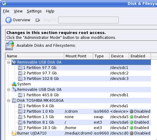

            I have 3 external hardrives formatted to NTFS. One is connected by Firewire, the other two are USB2.
            Details are below:

            in Kubuntu, it seems that these harddrives are given a different identity-tag depending on which drive I start... (sometimes the StorDisk1 is called /dev/sdb1 while other times its /dev/blaablaa ). Is there a way to mount each drive according to its label so that it doesn't "jump around"?
            I just turned on the 300 gb and the 500 gb external drives. I have included a JPEG of what is displayed by System Settings- Disk and FileSystems.

              USB connected HDs will reflect /dev/sxxx designations assigned during boot due to the way that the USB devices are accessed during the boot process. It's frustrating. But, you can avoid the frustration by using the UUID designation instead.
              You can see this in your fstab file for the partitions on your primary HD:
              # Entry for /dev/sda6 :
              UUID=c4512ba6-9225-486e-a054-89c456783f14 / ext3 nouser,defaults,errors=remount-ro,atime,auto,rw,dev,exec,suid 0 1
              # Entry for /dev/sda7 :
              UUID=705c2608-7208-41fb-81db-d1671468fb21 /home ext3 nouser,defaults,atime,auto,rw,dev,exec,suid 0 2
              You can modify your fstab for the USB HD partitions accordingly. The UUID information for your connected disk devices are located in /dev/disk/by-uuid. You can see them by opening a console and typing:
              ls -l /dev/disk/by-uuid
              or, you can type:
              blkid
