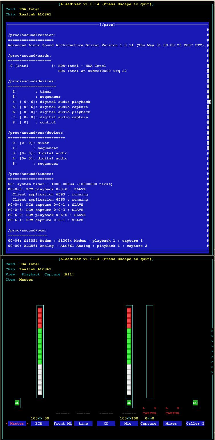

      I checked the alsamixer thing, and set the master and other output channels to on....
      I'm attaching my proc and volume level pages from alsamixer. If that helps.
