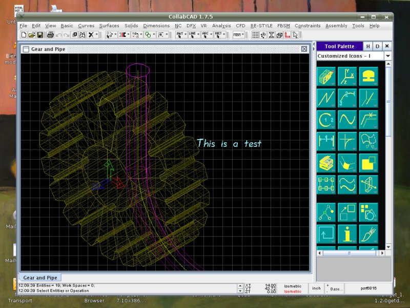

    Another screenshot in wireframe mode.
