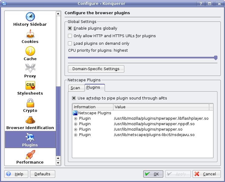

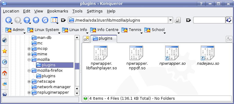

After this all you have to do is to right click on the resulting .deb file and choose "kubuntu package menu>install package enter password and you're done. nspluginwrapper should see the flash plugin in the /usr/lib/mozilla/plugins directory and install it automatically.
after this open Konqueror and in the settings menu >configure Konqueror>plugins and choose scan for plugins. In the plugins tab you should see the ns-wrapper with flash plugin. I don't use Firefox but I assume it should work as well.
Report back if you run into trouble.

I downloaded FlashPackege. Extracted all its files to /usr/lib/mozilla/plugins
Them downloaded those two other, put them to /home, and then created .deb file, using code you give.
Runned deb file..... it didn't looked like it installed anything at all.

It is easy to see if they got installed. Just go in Adept and see if they are there.
If not you may have done something wrong or u got some errors while running alien and did not notice them. It is very hard for me to troubleshoot from here. the procedure is correct and runs fine.
If the files appear installed in adept then you should probably follow the procedure on the nspluginwrapper site on how to install the plugin manually.
something like ns...wrapper -i "filename.so"
Have u scanned for plugins in Konqueror?
when u press the plugins tab.. nothing there?

Ok so I finally got around to doing this on my system, I was trying to deal with beryl problems first. Anyway, when I install nspluginwrapper I see it searching for plugins but nothing is found even though I extracted the flash plugin into my plugins folder. When I follow the instructions from the nsplugin site I get an error that the file is not a valid NPAPI plugin? Anyone know what this means?
