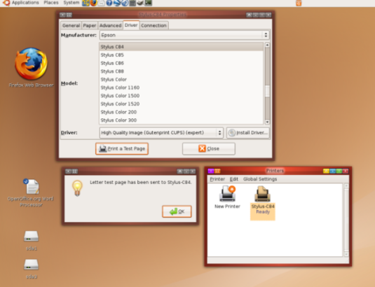

    If I hadn't just now installed my Epson Stylus C84 on my Ubuntu 7.04 64-bit system, I would probably just consider it an abandoned model. But how the heck could it be available in the CUPS database for Ubuntu Feisty, and not for Kubuntu Feisty? I made a couple of stabs with "stylus-like" choices, but they don't show any signs of working. Unfortunately, my driver CD lists 2 OSs, but neither of them are Linux. Epson's driver web site likewise has Windows and Mac drivers, but nothing for Linux for this model.
    Any ideas -- is there a CUPS site somewhere where one can get drivers, or do I need to go printer shopping?
    Thanks!
