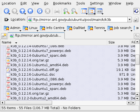

                    I figured something though:
                    Many packages are there and either there is a trick that I don't know on how to get them loaded or there are othere dependencies that are not resolved hence Adept does not offer the package for upgrade since it has some missing libs.
                    here is a snapshot of the dir contents:
                      Re: My most annoying issues with Kubuntu
                      Mmm... Okay I replied to the mldonkey post, it's not a perfect solution as it leaves some files behind, it does remove it.
                      http://kubuntuforums.net/forums/index.php?topic=6634.0
                      Is that a screeny of a repository?
                      You could try to cut and paste the url into the repository list of Adept.
                      But you'd still need the gpg key, correct?
                      I found these konsole commands earlier, would changing them to match the url help?
                      wget http://people.ubuntu.com/~jriddell/k...iddell-key.gpg
                      sudo apt-key add kubuntu-packages-jriddell-key.gpg
