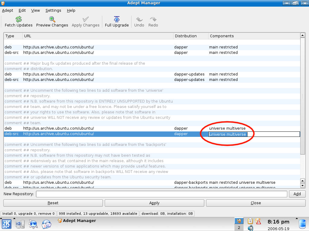

                    It sure is in dapper's multiverse. The first attachment shows my 2nd box's Dapper sources.list as seen via adept. It is purely stock except for enabling all the extra repositories that were originally commented out (universe, backports, etc) then adding "multiverse" to the same line as universe

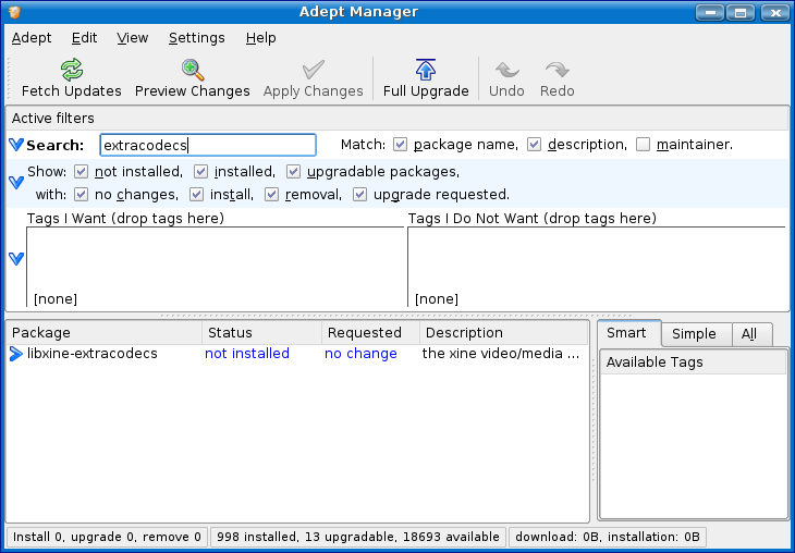

                    The second screenie shows my search results.
                    'nuff said; you just need to add "multiverse" to the section I circled in the first snapshot and fetch updates

                      Ah, nice screenshots claydoh...a picture truly speaks more than a thousand words
