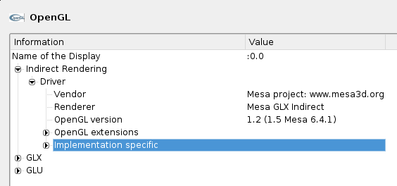

    When I look into KInfoCenter, I see that OpenGL is activated but the Vendor says Mesa project and the Renderer section says Mesa GLX indirect. Is that some kind of default parameter?

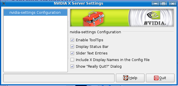

    I also checked the nvidia-settings, but as you can see below, there is not much there:
