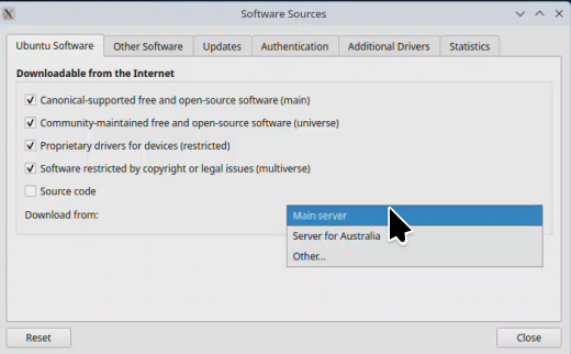

    To better edit this option, don't edit the file itself; use the Software Sources tool, usually accessed from Discover's settings area. I am not sure if this is broken in 25.10 like it was in previous releases. If you don't see it in Discover, you can open it using sudo software-properties-qt
    There is a section where you can change the server location. I'd suggest going for the Main instead of a different country or more local option, as this option will send you to a reasonably speedy server in the worldwide pool.
    Click image for larger version  Name:	Screenshot_20260501_143045.png Views:	1 Size:	92.0 KB ID:	691635​
