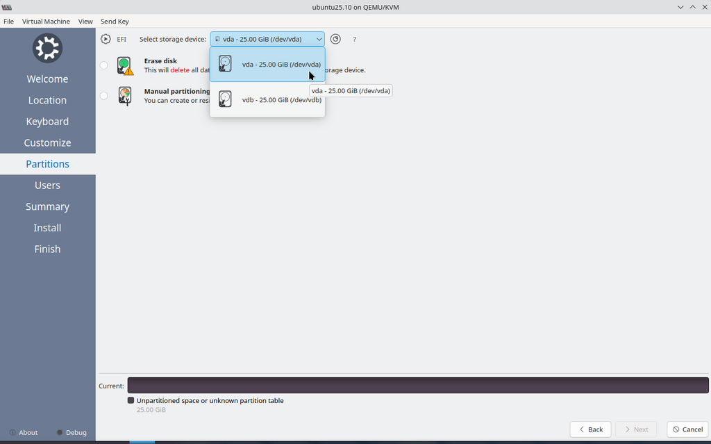

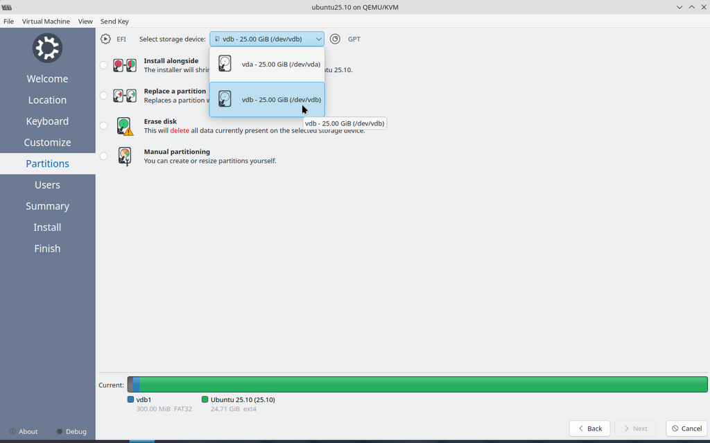

    Chucking up a quick virtual machine in virt-manager with two drives for an example:
ID:	690888​ Click image for larger version
    The left is the empty virtual drive, and the right is an existing Lubuntu install. Pretend this is Windows

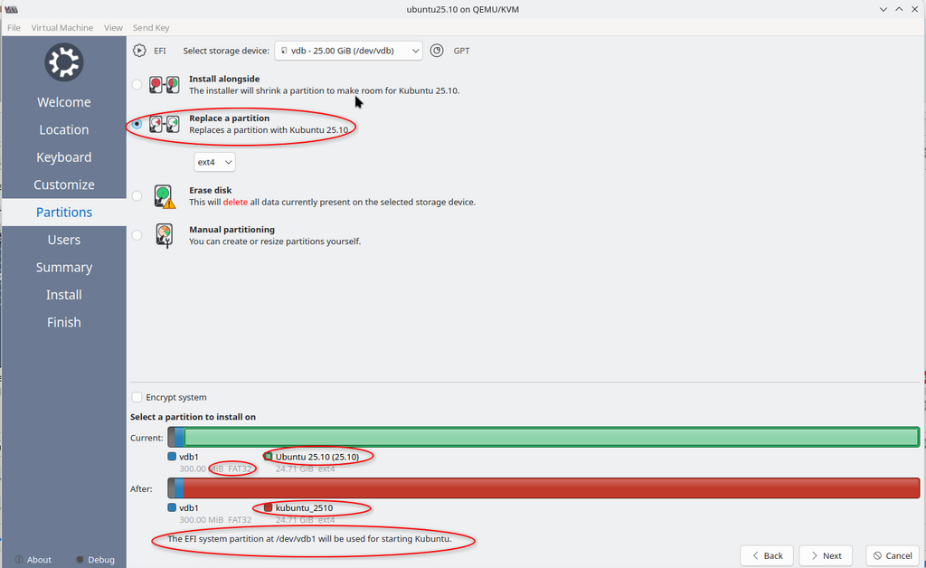

    It should select your existing EFI partition, as seen here.
    But if you worry about accidentally picking the wrong drive, go ahead and unplug the ones you don't want used. Install Kubuntu, and then reattach.
