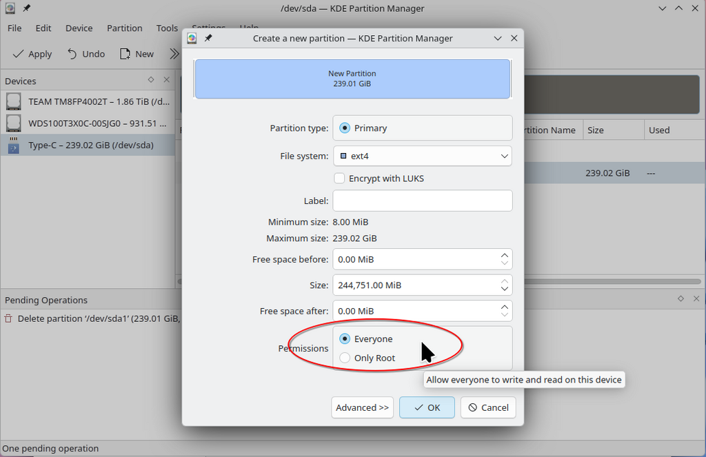

KDE Partition Manager is the tool to use:

Thanks for replying, now I have a new problem: in KDE Partition Manager, "permissions" -> "everyone" doesn't appear; only root does.

Ok, you must not be running Kubuntu 25.10.
Which version are you running? Hopefully not 25.04 or 24.10.
The Partition Manager does not have that option in older versions.
You would need to manually do what the application is doing:
sudo chmod -R +775 /media/<your-username>/foldername
