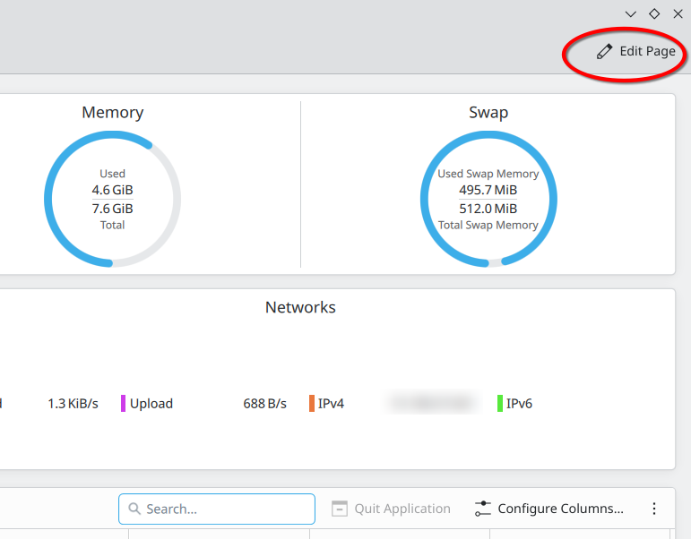

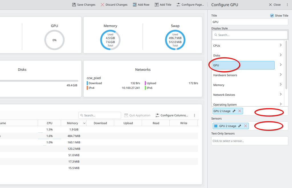

      You may need to go and edit that sensor widget to point to the correct hardware.
      But then you also need to make sure all supported hardware sensors are detected and enabled.
      You also may need to install and set up lm-sensors (only the very first part, the rest is not useful.) The System Monitor reads this soirt of info from the kernel reports and configured lmsensors data.
      But your gpu probably simply is not supported for this info. Intel iGPUs in my own experience usually don't.
      Editing the monitor is a bit tricky/funky/awkward/confusing, and there is no recent and halfway good set of instructions that I can find.
ID:	689861​Click image for larger version

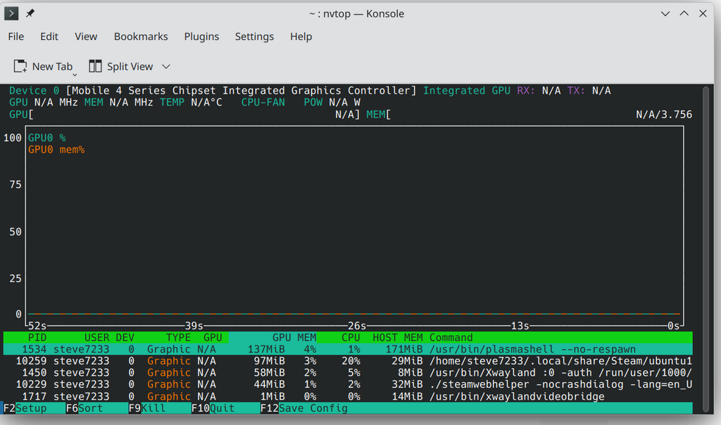

      nvtop (cli) should show Intel graphics usage, assuming your old one is using the i915 driver. It *probably* is, but not sure.

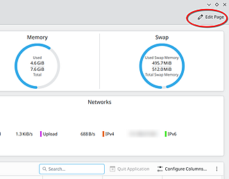

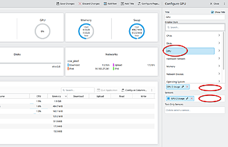

        Click image for larger version  Name:	Screenshot_20260111_050112.png Views:	0 Size:	60.2 KB ID:	689861​Click image for larger version  Name:	Screenshot_20260111_045950.png Views:	0 Size:	151.1 KB ID:	689862​
        What does this mean?
          It shows some GPU memory usage.
            I am thinking it might not be setting up Mesa correctly. One thread from my Google searches said that one person found there was a Mesa override that was incorrect, and they have the same GMA that I have.
              Last night I put nvtop in my autostart list, but it failed this morning:
              I tried copying and pasting, but it didn't work, so I had to use the Print Screen key.
