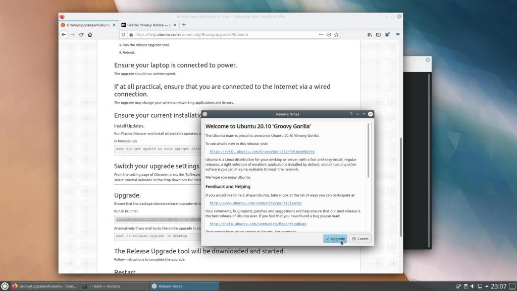

              I followed the upgrade instructions with no problems.

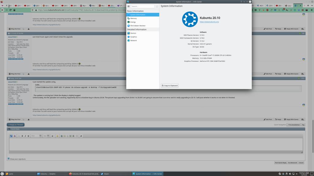

                    I just started the update using,
                    steve7233@steve7233-Z68XP-UD3:~$ pkexec do-release-upgrade -m desktop -f DistUpgradeViewKDE
                    . The update is running but I think the display is slightly bugged.
                    Unfortunately, the file uploader isn't working. Apparently due to a kioslave bug in Ubuntu 20.04. The picture says upgrading from 20.04.1 to 20.04! I am going to assume that is an error and it's really upgrading to 20.10. I will post whether it works or not when it's finished.
