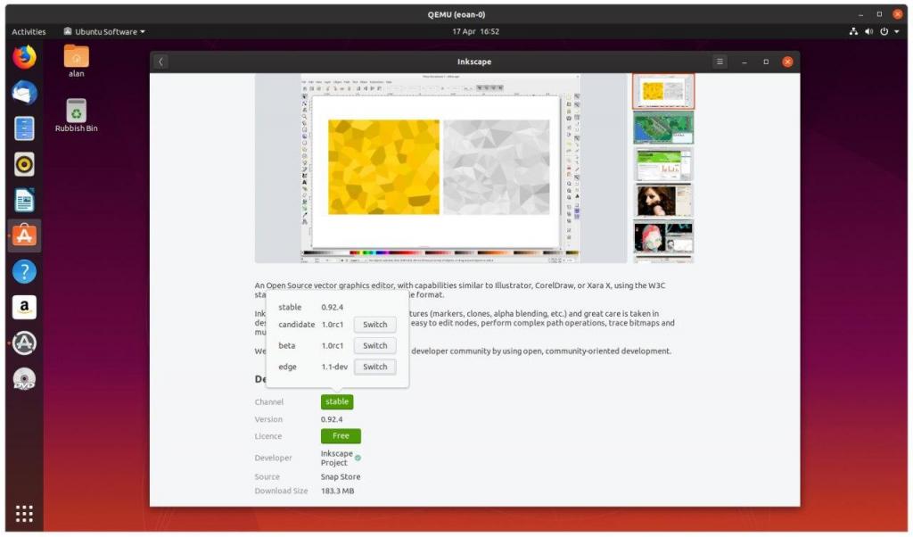

        It seems it's a known Discover bug with Snaps:
        Cannot choose snap channels https://bugs.kde.org/show_bug.cgi?id=418207

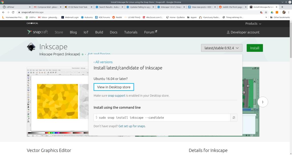

          While the 'Install' link that opens discover won't install the desired version, an alternative is going to the Snap Store, which will give the command to install the desired version

              I saw that but my aim is to get an install for normal Inkscape designers, without using the command line or resorting to any hacks or specialised knowledge. The more that can manage, the more beta testers on Linux we have. Most will use Windows at the moment. But if they can feel comfortable on Linux that would benefit us all.

                    On Kubuntu the barrier for non IT people appears to be Discover. I'm not concerned about numbers of plasma users. Gnome Software on Ubuntu does let you choose channels for Inkscape. So Ubuntu users can test the betas in an easy way.
                    So a positive result would be to get that fixed/enabled in Discover to the benefit of Discover users.
                    Alan Pope sent me this screenshot of Gnome Software on Ubuntu yesterdayClick image for larger version
                    It shows the Inkscape Snap with option to select different snap channels.
