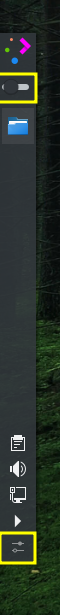

    This is what I have on 20.04:
    dkb@dkb-kuff:~/.local/share/plasma/plasmoids$ ls -lR
    total 4
    drwxrwxr-x 3 dkb dkb 4096 Jan 23 22:16 org.kde.paneltransparencybutton
    ./org.kde.paneltransparencybutton:
    total 36
    -rw-rw-r-- 1 dkb dkb   191 Jan 23 22:16 CHANGELOG.md
    drwxrwxr-x 4 dkb dkb  4096 Jan 23 22:16 contents
    -rw-rw-r-- 1 dkb dkb 18092 Jan 23 22:16 LICENSE
    -rw-rw-r-- 1 dkb dkb   527 Jan 23 22:16 metadata.desktop
    -rw-rw-r-- 1 dkb dkb  1235 Jan 23 22:16 README.md
    ./org.kde.paneltransparencybutton/contents:
    total 8
    drwxrwxr-x 2 dkb dkb 4096 Jan 23 22:16 config
    drwxrwxr-x 2 dkb dkb 4096 Jan 23 22:16 ui
    ./org.kde.paneltransparencybutton/contents/config:
    total 4
    -rw-rw-r-- 1 dkb dkb 457 Jan 23 22:16 main.xml
    ./org.kde.paneltransparencybutton/contents/ui:
    total 8
    -rw-rw-r-- 1 dkb dkb 4533 Jan 23 22:16 main.qml
    This is a clean install of 20.04 (full version) in a VM and fully updated.
    I obtained the button with Get New Widgets choosing v0.2.
    Then, by right-clicking on the Desktop and choosing Customize Layout > Add widgets, I dragged the button widget on to the panel. I've found that a bit tricky! Sometimes, a dragged widget is invisible!!!
    dkb@dkb-kuff:~/.local/share/plasma/plasmoids/org.kde.paneltransparencybutton$ cat CHANGELOG.md
    ### CHANGELOG
    #### Version 0.2
    * support only Plasma Desktop>=5.18
    #### Version 0.1
    * use Switch element for activating/disabling panel transparency
    * hide when plasma widgets are locked
    In the following images:
    1 is before installing the widget
    2 is immediately after installing it without turning on transparency. The top yellow box has the button. The bottom yellow box shows that the panel is in "configure/edit/unlocked" mode.
    3 is after turning on transparency. The panel background is gone and the button looks different but the bottom icon is still there showing that the panel is still in "configure/edit/unlocked" mode.
    4. Now the button is invisible and the bottom icon is gone. I did that by closing the small panel that appears by right-clicking on the Desktop and choosing Customize Layout.
    Kubuntu 20.04
