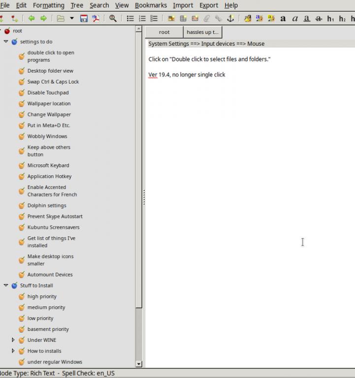

    If I do have to install from scratch, I do have all my settings documented in a CherryTree file. There I also have documented every application I've installed, and info on how to install it if it's not a repository one. Everything I've done is documented, fortunately, but a distro install from scratch still represents weeks of work to get back to where I am now.
    Is there some way to save all my Kubuntu settings and then import them after I do an install from scratch? That's basically what I do with LibreOffice. I keep my LO profile saved, and then if I do a distro change or a LO Office reinstall, I just have to copy my LO profile into the new install. Saves me a lot of time. If something like that exists for my Kubuntu settings, that would save me a huge amount of time. Then in my CherryTree documentation file, I have the apps I used categorized into different branches named as "high," "medium," "low," and "basement" priorities. I've done it that way for a while so that if I ever have to start from scratch, I'm at least well organized to get the important stuff installed first.

          I've successfully upgraded to 19.10, thank God. I'll make sure to do the one to 20.04 before anything like this happens. I'm saving your "dirty" settings save thing, just in case I ever need it. What I've been doing is keeping a detailed record in CherryTree of all my settings and of everything I have installed, and I categorize all the applications between "high," "medium," "low," and "basement" priorities. It helps a lot if I ever have to reinstall from scratch. Here's a screen shot of it. It's still a lot of work to get set back up, but at least I'm well organized, and I can concentrate on the settings and on the "high priority" apps.
