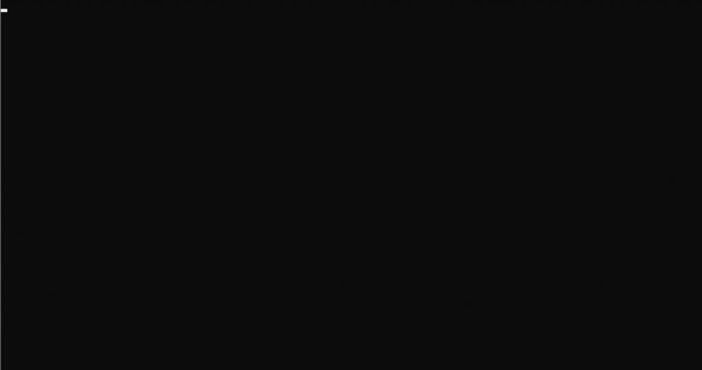

    hello, Does anyone have trouble starting Kubuntu 19.10 after installing in UEFI mode? I am installing correctly with the disk in GPT and partitioned by 512mb EFI, /, / home and swap, the installation finishes correctly, but after rebooting it starts the system with the Kubuntu logo and it appears a _ blinking and no longer continues.
    basically my installation is exactly like this video https://youtu.be/SCWhdcLgHao?t=188 , but it stays on screen black with
    _ blinking.

          When at the blinking cursor, can you open a terminal session?
          If so, can you enter efibootmgr -v and get something like this

              jglen490 won't let me write "efibootmgr -v" or anything ..
              But thanks everyone for trying to help me. You can now fix the problem in Kubuntu 19.10 and and in beta 20.04
              Basically it was because of the nvidia or Nouveau drivers that couldn't start
              What I did was simply press the "E" key during boot, before the grub starts and add "nomodeset" just after "quiet splash", and save with the "F10" key and finally you can start the OS in low resolution, no Nouveau / Nvidia driver.

              Here you can already install the official nvidia.run drivers, no need to disable or blacklist Nouveau. Ready, I hope to help others too..
