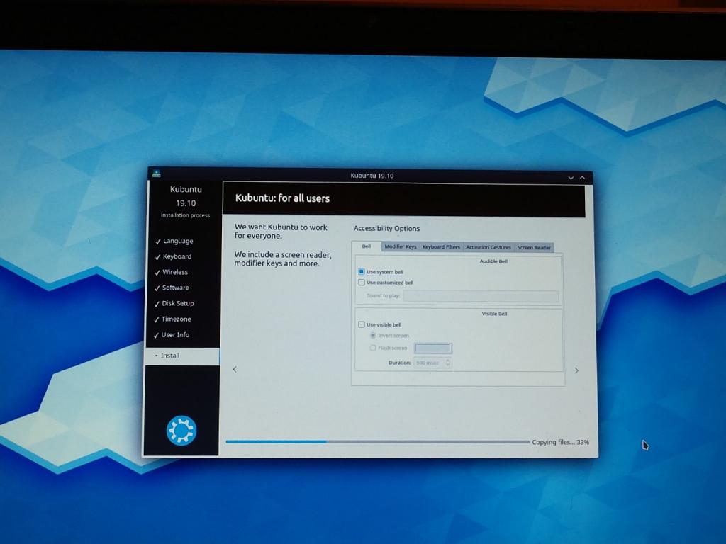

                  It's all good, guys!
                  Will write more later.
                      Okay, I'm back. I'm using my phone right now, as I needed to lie down for a bit. But the laptop is up and running 19.10 and is blazingly fast! I have a whole lot to do before I'm "done" (are we ever really done tweaking our computers?), and will start tackling that in the morning.
