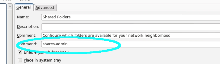

    I used KRDC to view the Compaq from the laptop, and I looked at various settings on it. One thing I found straight away was this:

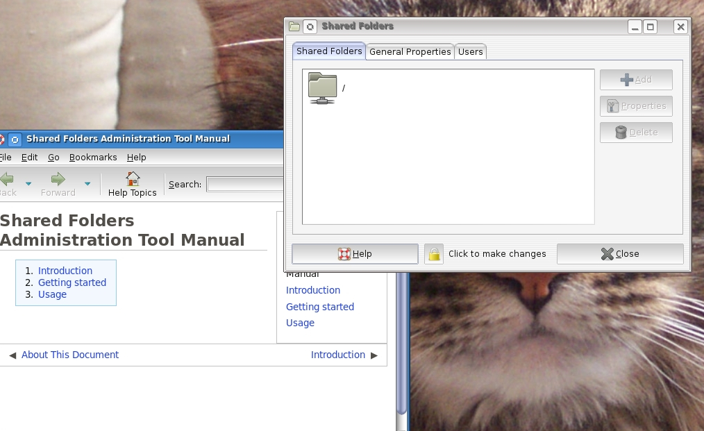

    which is where I set its share name, shared directory, etc. I looked at its actual command:
    and saw shares-admin, which I immediately looked for on the laptop, but couldn't find. I searched through Synaptic looking for anything that may have replaced that, but found nothing.

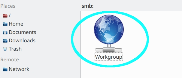

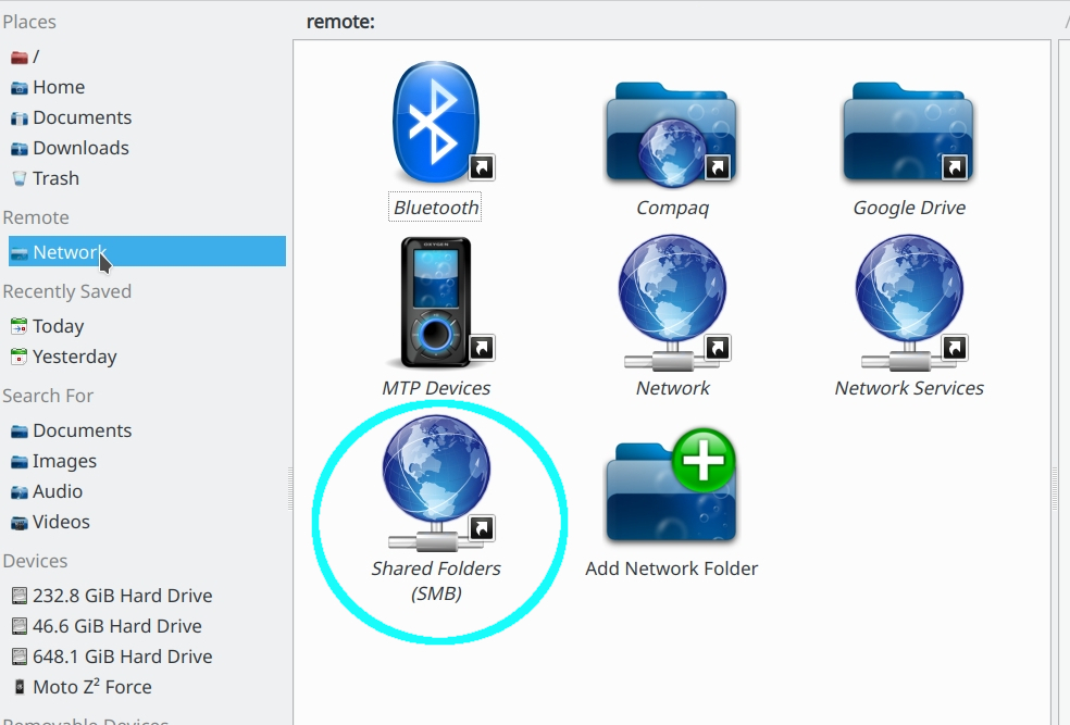

    So this is where I am now. In Dolphin:
    selecting Shared Folders (SMB) I get this:

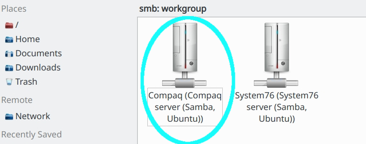

    selecting Compaq:
    [continued in next post--can't add more than 5 images]
      [continued from previous post]

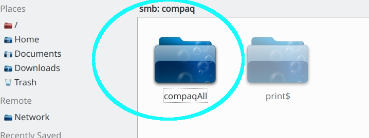

      selecting Compaq I get this:

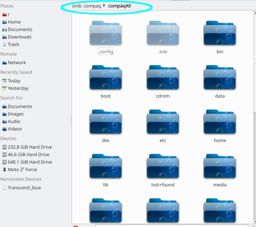

      and, finally, selecting compaqAll I get the full contents of the Compaq:
      So the laptop sees it, connects to it via various methods (KRDC,SMB in Dolphin), but I cannot mount it. When I try, I get:

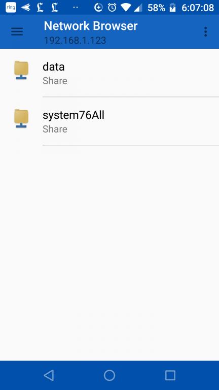

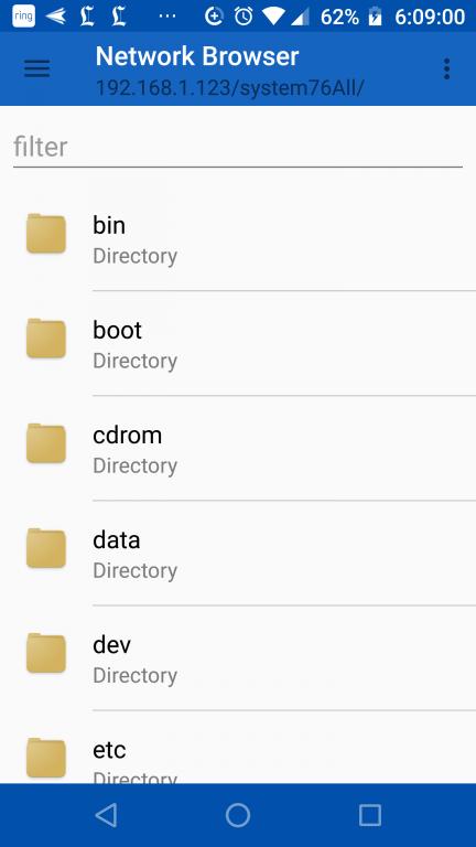

              Yesterday in Dolphin, logged in as root, I right-clicked on data (which is my partition, /data) and used its 'properties' tabs to share it. I gave full control to me (my normal user account). There was no opportunity to require, or supply, a password. I repeated the process on / and then logged out.
              Later, on my Android phone, I opened one of my apps--that's historically been flaky about connecting to my computers. But guess what? It not only saw both system76All (the share name I'd given /) and data:
              it OPENED THEM with no credentials required!:

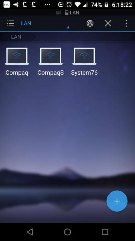

              Full read/write access to the entire hard drive. But...when I tried numerous other apps--that consistently, reliably connect to my computers--they all saw the laptop:
              but not a single one could access its files. They failed in different ways. Some prompted for user/pass, but after supplying my credentials, or checking 'anonymous,' they couldn't open them. Others just kept spinning after I selected System76 (the laptop's name):
              They see its IP address (192.168.1.123) but that's as far as I get. And I'm thoroughly confused!
