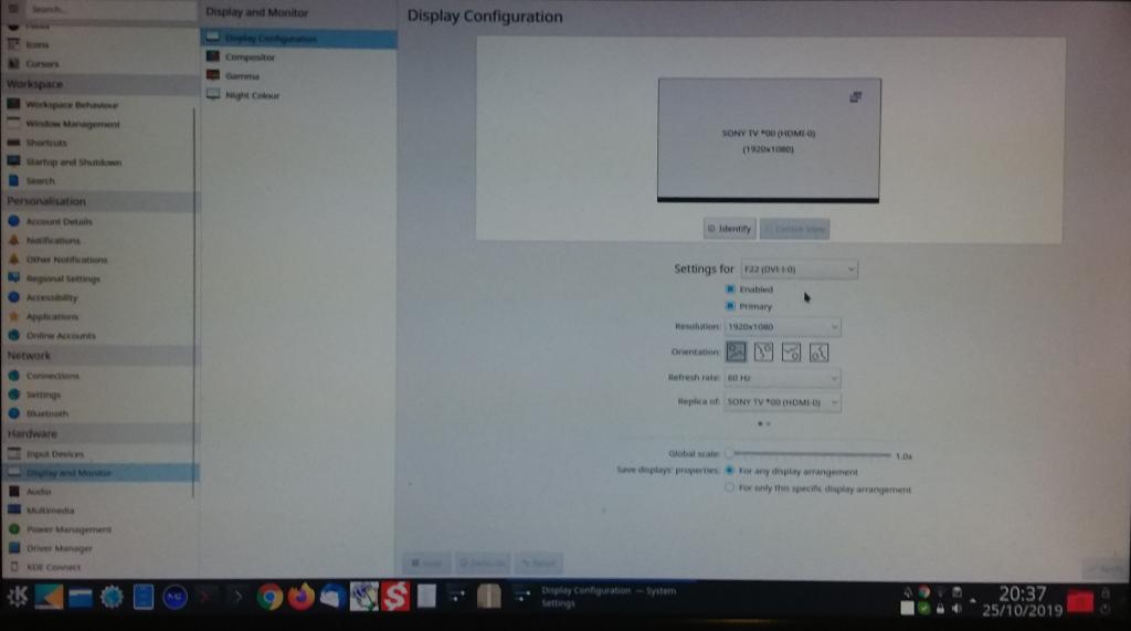

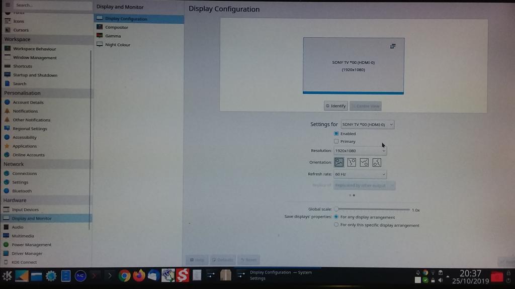

    No luck here.
    Only progress is if I unplug and plug in monitor via HDMI and screen will pop up asking which mode I want (dual, XOR, expanded left/right). After choosing mode monitor immediately reverts to power saving, always blank second screen.
    Settings screen shows no option for second screen.
    More luck here. Monitor plus HDMI cable to the TV, both are working. The settings display page looks a bit different in 19.10
