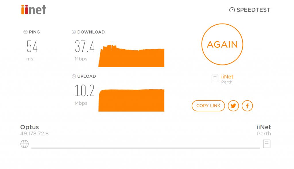

            I have decided to give specific visual examples of the speed that I am getting with USB Tethering from my Wife's Samsung S6 and my Samsung S10e.
            My Wife's S6 gives the following result:
Name:	Speed Test S6.jpg

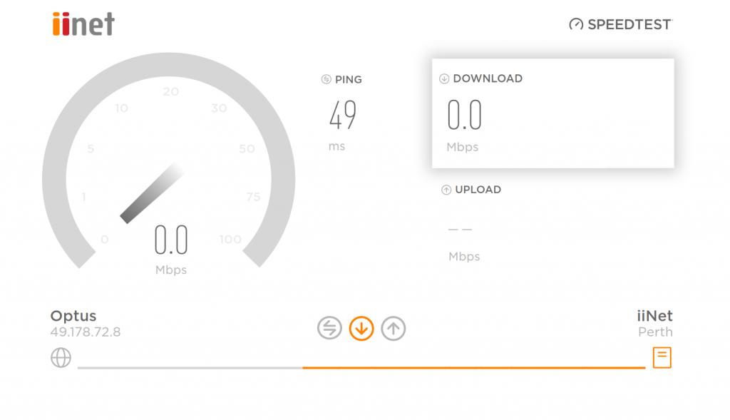

            When I connect my S10e, I get the following:
Name:	Speed Test S10e.jpg
            I took this image just before it vanished with the message that it failed to connect to the server.
