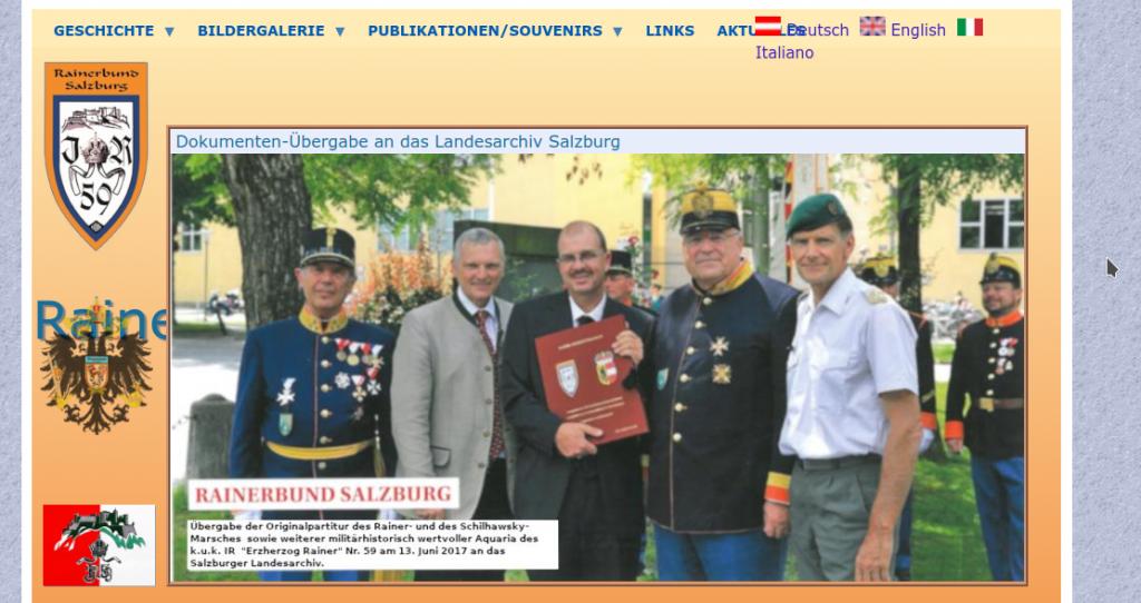

    In the image included below, the language icons/text (ie. Deutsch/English/Italiano) are incorrectly rendered as two lines -
    the remaining space on the right being to little - in 19.10/Nvidia. They are correctly rendered as just ONE line in
    19.04/Nouveau.
    Also, the large text "Rainer Regimentsmuseum..." is positioned correctly to the right of the "logo" image just
    underneath the menu at the top of the page in the 19.04/Nouveau case, and NOT further down the page - obviously
    also because of too large a font in 19.10/Nvidia.
