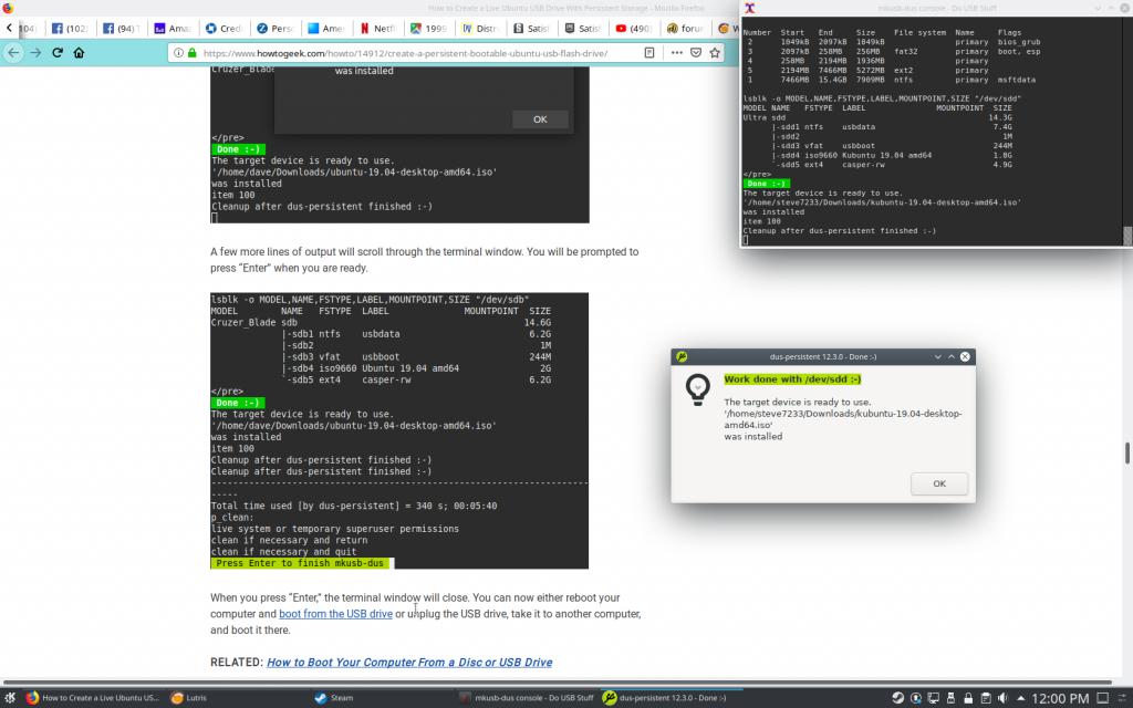

          As you can see the final instruction on the web page doesn't totally agree with what I see. Probably just a newer version of dus-persistent - version 12.3.0 -. Thanks for the info. I will give it to my brother later and see if it works.
            Oops forgot to attach the screenshot.Click image for larger version
Name:	work done difference.jpg
              Copying and pasting the terminal output here is Waayyyyyyy wayyyyyyyyy wwwwwwwaayyyyyyyyyyy better than a blurry-ish jpg image that some may have to download, open in gwenview and then zoom in on.........
              Or at least do a screengrab of just the Window of Importance TM
              anyhoo, I won't type it out as I iz layzee, but the 'usbdata' probably indicates that you have the persistence thingy . this would not be found on a normal install disk.
                It seems to work now.
