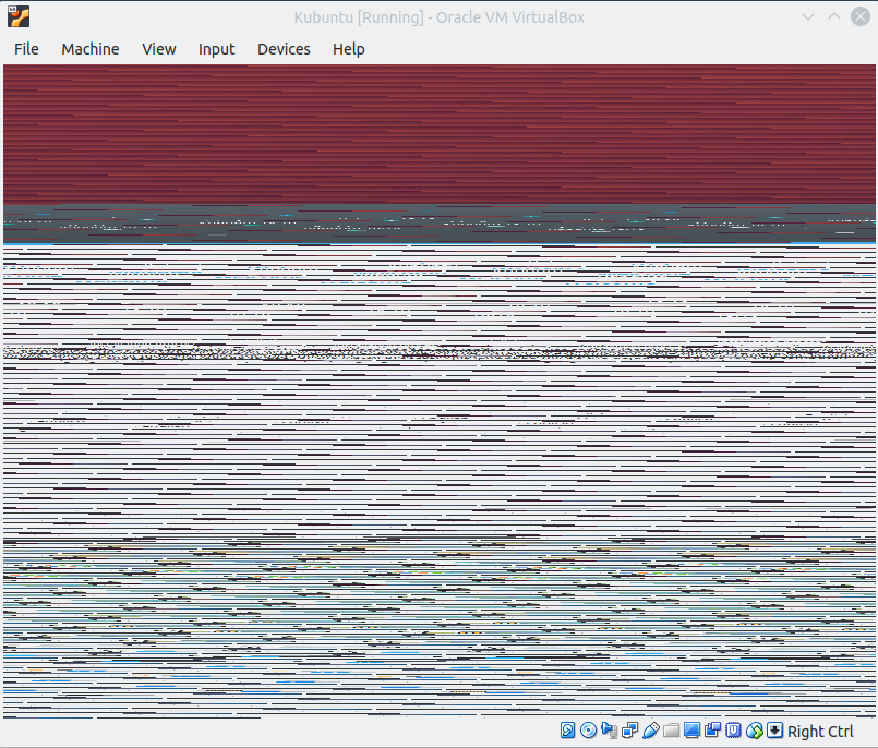

    Is anyone here testing 18.10 in a Virtualbox VM?
    I just tried to install the official beta and two different daily builds but none work.
    VM settings are "Ubuntu x64", 2GB RAM, 10GB disk.
    Both boot all the way to the "Kubuntu 18.10" message and when (I guess?) the graphics mode gets initialized the daily builds change to the picture below and the official beta just stays black with no disk or cpu usage.
    I am running the latest version of VirtualBox, 5.2.18

      I don't even get that far...it fails at the very beginning of booting from the ISO.
      First I see is this little chart at the very bottom which indicates it's booting from an external device (I think)
      Next the screen turns black and I see "Kubuntu 18.10" for a second or two and then I am stuck with the interference/black screen

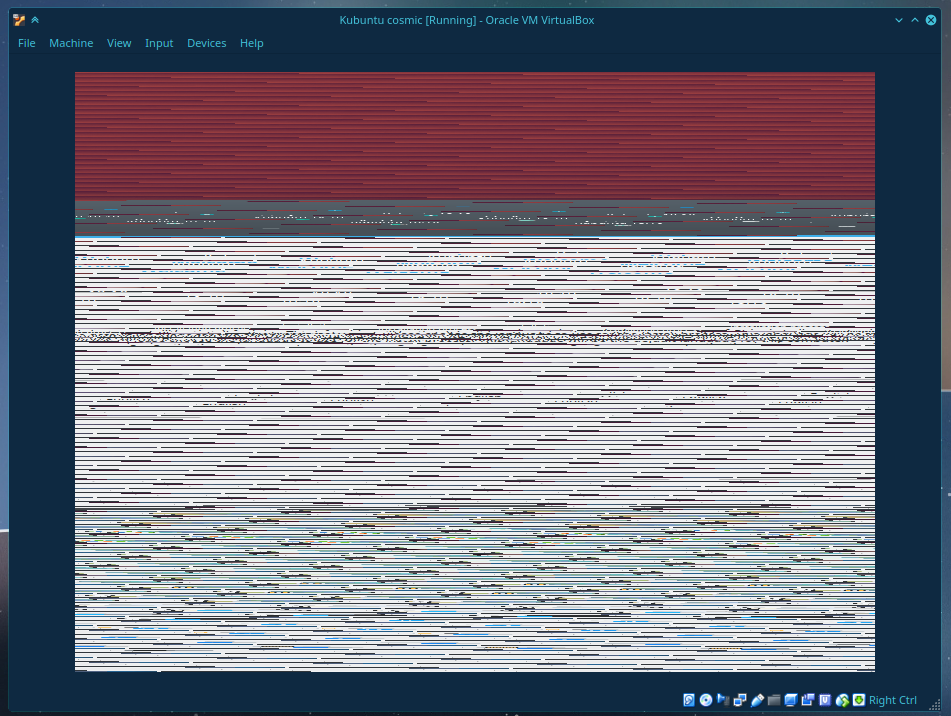

            That is odd, because enabling it in a test boot of a VM, I get a screen identical to what you report.

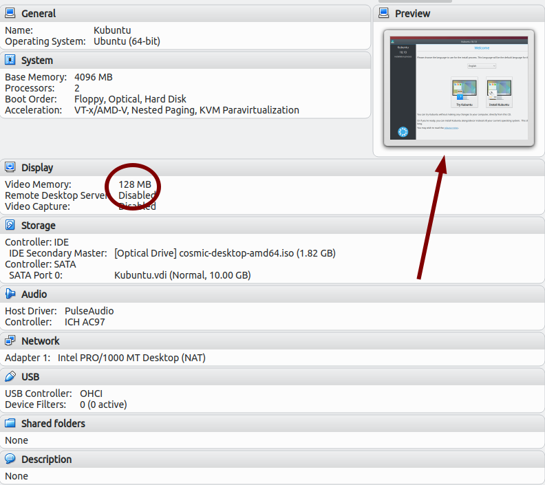

                      I went with the VirtualBox defaults for Kubuntu, actually upped the RAM from default 1GB to 2GB, video memory was 16MB. The 10GB for disk felt small but I thought I'd get a warning if not sufficient.
                      Just tried again with 4GB RAM and 32MB and 64MB for video, didn't change things.
                      The VM still gets stuck at 00:00:24.578316 GUI: UIFrameBufferPrivate:erformResize: Size=800x600, Directly using source bitmap content
                      Edit: Initially one cpu, for the additional runs I used 2 processors
                      Edit2: The Ubuntu 18.10 image just worked with the new settings...need to play around some more to see if I can get Kubuntu to run as well.
                      Edit3: Kubuntu didn't work with 64MB of video RAM but when I went up to 128MB it went through

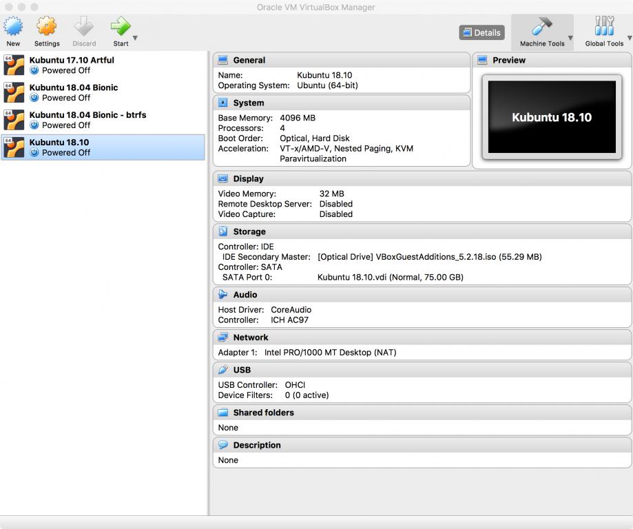

                        Just finished installing 18.10 (Kubuntu) in a VirtualBox VM. No issues like you described.
                        I set the VM for 32MB of Video Memory, 4 CPUs, and 4096MB Base Memory. The VM is 75GB, partitioned as 25GB (root) and the rest Home (/home), all ext4.
