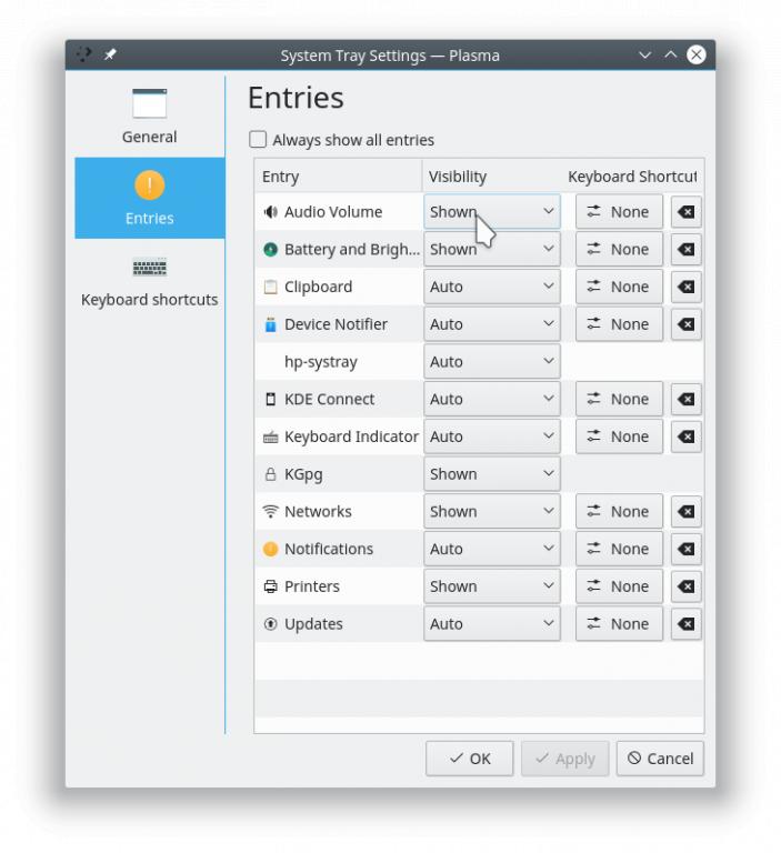

    Right mouse on the system tray area and choose system tray settings.
    Make the settings shown:

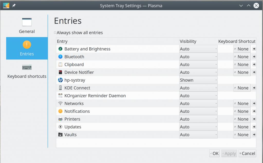

      I am dealing with Cosmic and I have already done that and know all about that option. What I get on cosmic does not include Audio. What I get is shown below.
              [ATTACH=CONFIG]7648[/ATTACH]
              [ATTACH=CONFIG]7649[/ATTACH]
