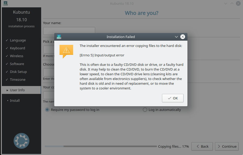

    hi all,
    need help
    while installing kubuntu 18.10 cosmic from the iso written to a usb flash drive
    i get this error installer encountered error copying to hard disk
    this happens while i see a message on the status bar copying files and around 17%
    and in addition in dmesg and syslog the following messages appear
    [  957.091911] SQUASHFS error: zlib decompression failed, data probably corrupt
    [  957.091916] SQUASHFS error: squashfs_read_data failed to read block 0x9e1d10c
    [  957.091918] SQUASHFS error: Unable to read fragment cache entry [9e1d10c]
    [  957.091920] SQUASHFS error: Unable to read page, block 9e1d10c, size 7c2a
    i did a md5sum comparing the flash image and the iso file downloaded apparently they match. hence it isn't likely due to a corrupted image on the flash drive. i.e. it is identical to the downloaded iso. and the fact that 17% is copied means that there isn't a problem reading other files
    any idea how to resolve this?
    thanks in advance

      it doesn't seem like a problem with the hard drive, as the messages
      apparently seemed to be that the installer is trying to read some files from the cdrom - in this case the usb flash drive
      but it is unable to read from the usb flash drive. note that i've checked the md5sum hash and that they are identical to the original iso file the whole image. hence it isn't an error on the usb flash drive. and neither does it have any issues reading from or writing to the hard drive. the squashfs error repeats every time it reads 17% from the usb flash drive this further shows that it is a problem reading the files from the kubuntu iso image
