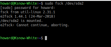

          Okay, jglen

            Well, I did write sudo
            If you can boot it, and it's Linux, you can sudo fsck /dev/sda2 from it.
            Or run it from a live DVD/USB.
            And suggested you do it from the other OS or a live medium because... you can't run it on a mounted partition.
            Still, if it ran from the recovery prompt, all is good... hopefully. Because in my (limited) experience when that happens, more often than not the disk is starting to have problems - and they usually get worse, not better.
            It doesn't have to be the case, but... I would set it to check the disk at startup often.
            And, you know, backup and all ;·)
              If /dev/sda2 is your Linux OS partition, you will have run that command from a Live Distro USB because the partition has to be unmounted to run fsck on it. I know you said that one of your three OSes in Windows 10, but if you have another Linux as your third, you could boot to that third distro and run fsck from there.

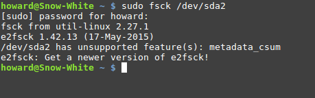

                I ran sudo fsck /dev/sda2 in Linux Mint.
                Here is a screenshot of the result.

                So I followed Don B Cilly's advice and used the busybox command - which worked and got me going again.
