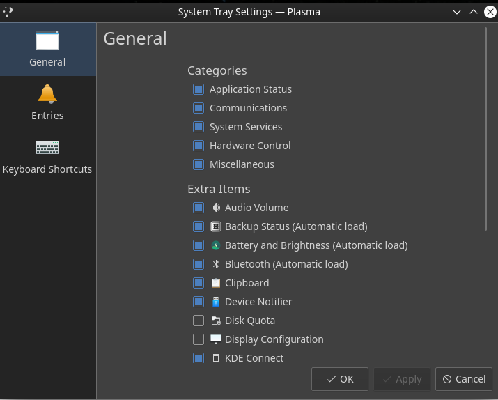

              Well, that's probably a separate problem. You could check in System Setting, Notifications, for that... except I can't find any reference to removable drives there... there is an entry for removable storage, but it doesn't mention notifications... it doesn't seem to be in Widgets either.
              Anyway, it probably would be interesting to know if Dolphin showed unmounted partitions.
              [EDIT Oops. I found it. It's in the System tray settings :·) Device Notifier...

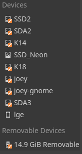

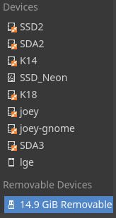

                    See, in my Places, unmounted devices have a Click image for larger version
ID:	644270 icon. They still show there, whether mounted or not, and whether fixed or removable.
                    And whether I open Dolphin before or after inserting the removables.
                    I left click to mount them (and open them), right-click to unmount them.

                              About notifications,
                              maybe you missed my edit?
                              [EDIT] Oops. I found it. It's in the System tray settings :·) Device Notifier...
