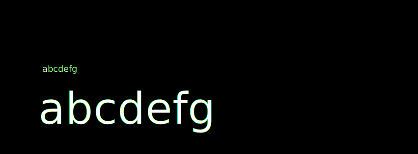

    Hello, After I upgraded to Kubuntu 18.04 I have noticed a problem with antialiasing in GIMP causing a green edge on lettering. I have looked it up in GIMP forums and support and it is always pointed out that it is a conflict in the OS with some package or a setting. I have tried adjusting the settings in System Settings>Fonts, but nothing I do there changes the behavior. If I turn off antialiasing in GIMP, the color goes away, but then the lettering looks terrible. (The attachment shows sample text that should be white)
    How do I go about troubleshooting this. I use GIMP regularly professionally and I need this to work.

    Do you have the latest Gimp?
    have you tried disabling subpixel rendering in System Settings?
    it might be worth either trying a more up to date gimp, either via a PPA, or (preferably) using Gimp's official flatpak.
    https://www.gimp.org/downloads/
    https://gitlab.gnome.org/GNOME/gimp/issues/3065
      On Kubuntu 18.04 I have Gimp 2.10.12 which is working very well and I installed it by using:
      sudo add-apt-repository ppa:otto-kesselgulasch/gimp
