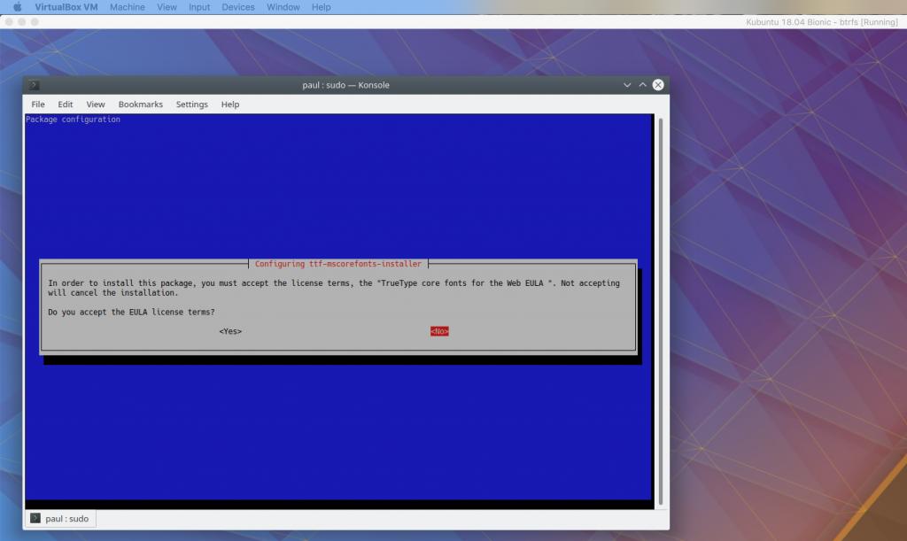

                      Here, in my 18.04, I just initiated the installation of ttf-mscorefonts-installer from the Command Line (sudo apt-get install ttf-mscorefonts-installer). This is the EULA screen that appears immediately:
Name:	Screen Shot 2019-01-12 at 8.49.25 AM.jpg
                      You don't see this?

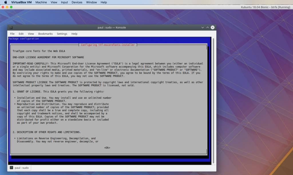

                      With this screen showing, just press Tab and the <Ok> becomes highlighted:
Name:	Screen Shot 2019-01-12 at 8.53.31 AM.jpg
                      Once highlighted you just press Enter.
                      The EULA Acceptance screen then shows, with <No> preselected (highlighted):
Name:	Screen Shot 2019-01-12 at 8.58.02 AM.jpg
                      Again, press Tab to select <Yes> and then press Enter:

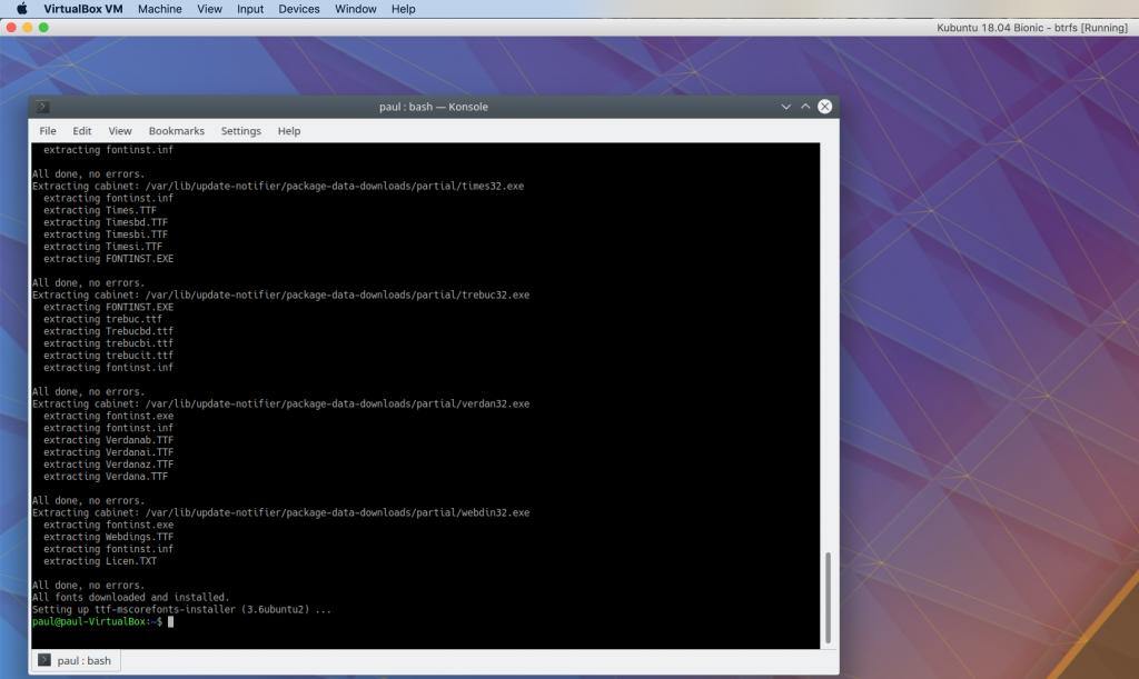

                      This window will then close and the installation will continue, and when finished, you'll see:
Name:	Screen Shot 2019-01-12 at 9.01.33 AM.jpg
                      Done.
