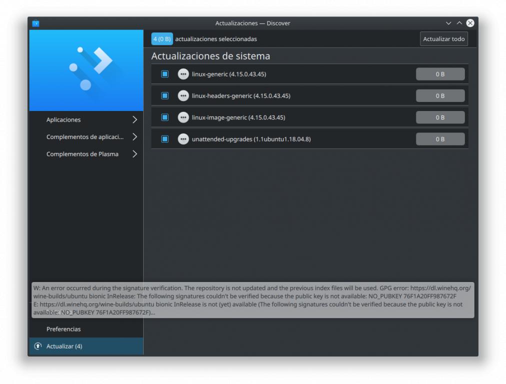

    hi, 4 days ago i cant update, it shows this problem:
    with the konsole neither work.
    https://wiki.winehq.org/Ubuntu
    The WineHQ repository key was changed on 2018-12-19. If you downloaded and added the key before that time, you will need to download and add the new key.
      I do find Discover a bit fussy at times regardless of your issue as pointed out by @acheron and sometimes just have to use
      sudo apt-get dist-upgrade
