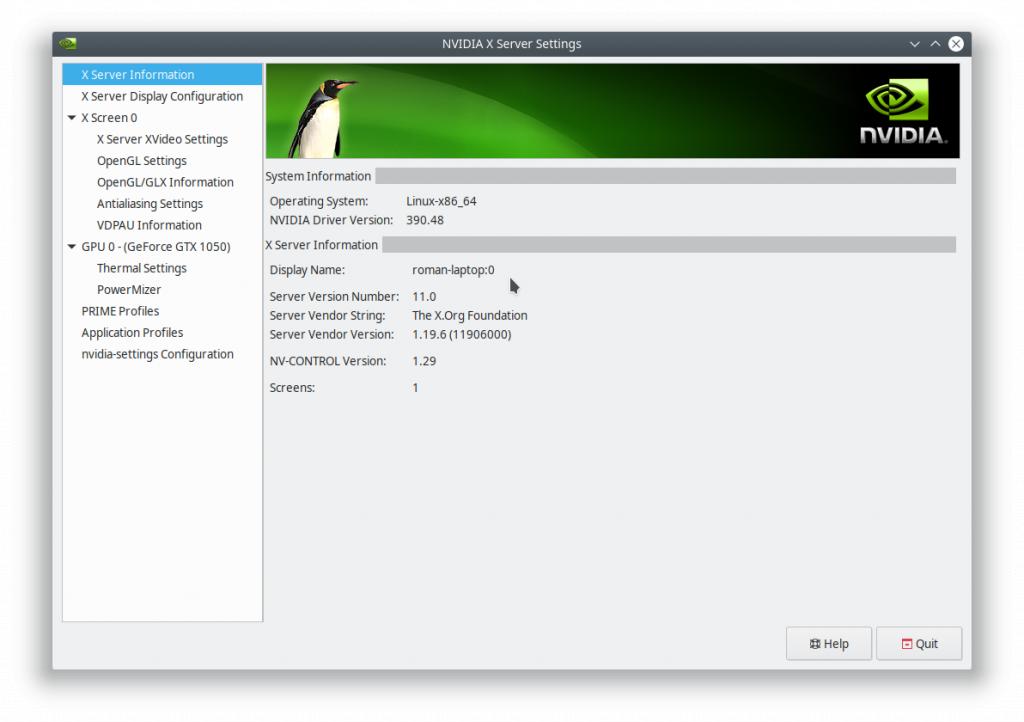

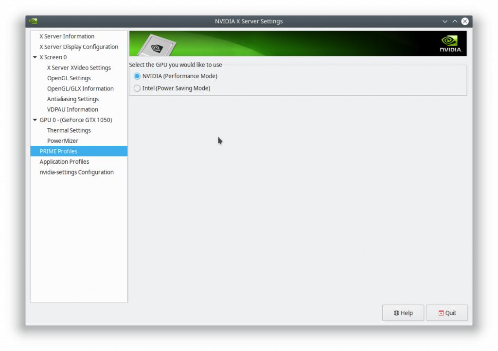

      Nvidia settings shows following options and groups:
      • X Server Information
      • X Server Display configuration
      • X Screen 0
      • GPU 0 - (GeForce GTX 1050)
      • PRIME profiles (NVIDIA is selected)
      • Application profiles
      • nvidia-settings configuration
      I went into BIOS, but i could not find anything related to disabling the intel graphics.
      Also the black screen was kind of weird. I couldn't go into terminal by pressing Alt + Ctrl + F1 or F2. The only way i could boot into GUI is from recovery menu.
        Also i enabled Show FPS in desktop effects and it shows shows 60 or more fps, but it definitely does not feel that way

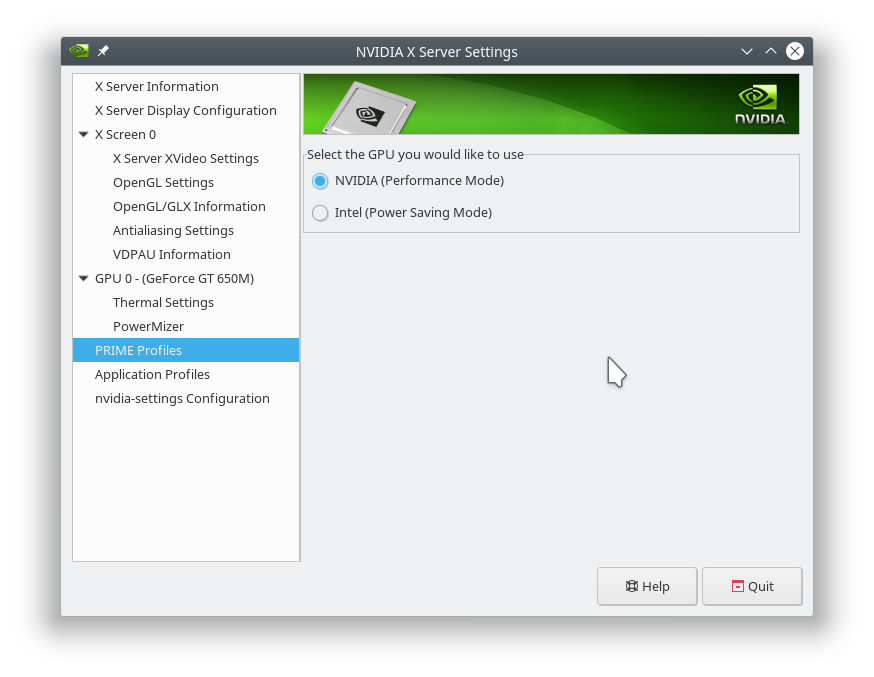

          Are you able to see something like this when you display the NVIDA configuration screen?

            Yes, exactly the same
