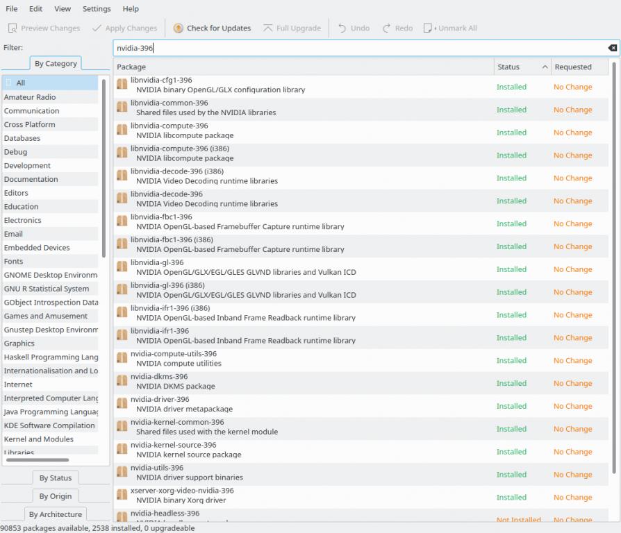

              The ppa that I used for the Nvidia driver is:
              sudo add-apt-repository ppa:graphics-drivers/ppa
              To make sure that my card is working, I found the command and the results are:
              :~$ sudo lspci | grep ' VGA ' | cut -d" " -f 1 | xargs -i lspci -v -s {}
              00:02.0 VGA compatible controller: Intel Corporation 3rd Gen Core processor Graphics Controller (rev 09) (prog-if 00 [VGA controller])
                   Subsystem: ASUSTeK Computer Inc. 3rd Gen Core processor Graphics Controller
                   Flags: bus master, fast devsel, latency 0, IRQ 26
                   Memory at f7400000 (64-bit, non-prefetchable) [size=4M]
                   Memory at d0000000 (64-bit, prefetchable) [size=256M]
                   I/O ports at f000 [size=64]
                   [virtual] Expansion ROM at 000c0000 [disabled] [size=128K]
                   Capabilities: <access denied>
                   Kernel driver in use: i915
                   Kernel modules: i915
              01:00.0 VGA compatible controller: NVIDIA Corporation GF108M [GeForce GT 630M] (rev a1) (prog-if 00 [VGA controller])
                   Subsystem: ASUSTeK Computer Inc. GF108M [GeForce GT 620M/630M/635M/640M LE]
                   Flags: fast devsel, IRQ 11
                   Memory at f6000000 (32-bit, non-prefetchable) [disabled] [size=16M]
                   Memory at e0000000 (64-bit, prefetchable) [disabled] [size=256M]
                   Memory at f0000000 (64-bit, prefetchable) [disabled] [size=32M]
                   I/O ports at e000 [disabled] [size=128]
                   Expansion ROM at f7000000 [disabled] [size=512K]
                   Kernel modules: nvidiafb, nouveau, nvidia_drm, nvidia
              My Muon listing for Nvidia-396 is:
              I hope this clarifies what I have done and will hopefully lead to a solution.
