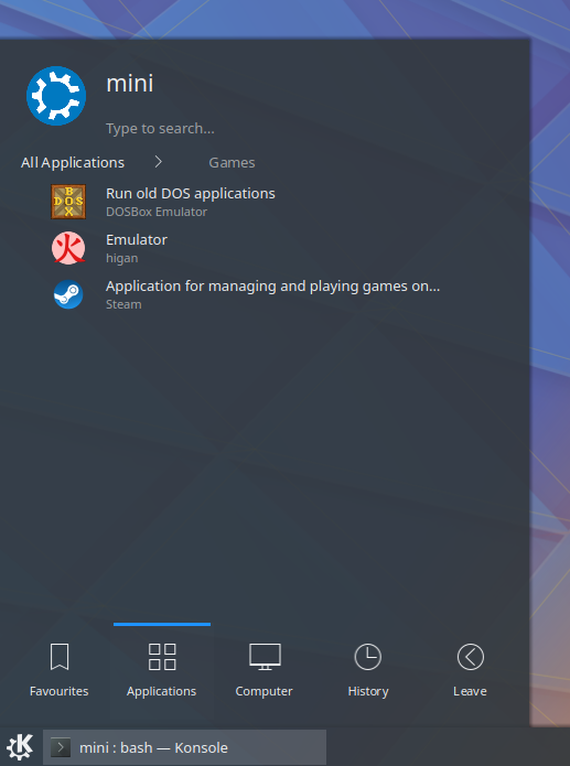

            Works for me in current builds.
              It does not work in classic "Application Menu" Start menu widget...
              Jesse

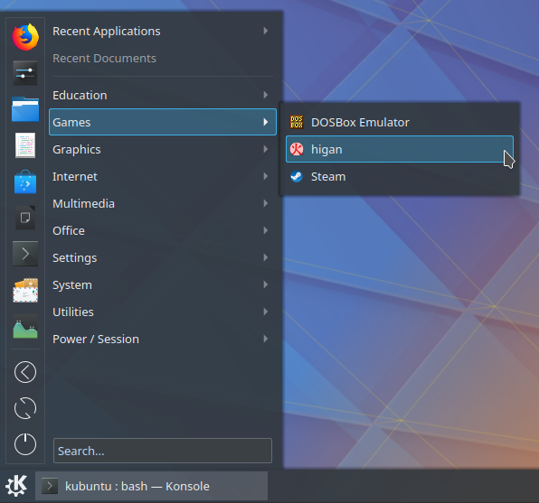

                It does work.
                  Fresh install of current Kubuntu 18.04 64Bit LTS...
                  ...full update...
                  ...Added classic "Application Menu"...
                  ...installed "DOSBox", "Higan", & Linux "Steam"...
                  ... Start/Games is shown grayed out with nothing in it
                    It does not work on a clean install when installing games using Package Manager.
                    If I install using Discover it does work...
                    Something wrong with games in Package Manager with "Application Menu"...
                      sounds to me that the menu rebuild was missing from the post install step.

                        Fresh install from daily builds, full up to date:
                        Swiched to kicker (classic style K menu)
                        Snap-shotted install so I could roll back.
                        Install games mentioned via discover:
                        They appear in a games menu as shown
                        Rolled back
                        Install games mentioned via muon package manager:
                        Rolled back.
                        Install games mentioned via apt:
                        Sorry, but I cannot replicate your issue.
                          Yes that sounds right. Could be confirmed (or not) by restarting the PC after games are installed. If it is the case, however, it would be weird that Muon would only do so for the Games category though.
                          By the way - the preferred way to install full applications in Kubuntu would be via Plasma Discover. Muon is meant for installing needed individual packages. Still, installed applications procured via Muon should show up in the menu.
