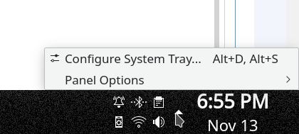

        Also, what is this "battery and brightness" never had that before, and how do I disable or remove it.
        The clipboard is also a new annoying feature. I have clipboard on my main PC, but it doesn't keep popping up and saving everything.
          The clipboard (Klipper) has been a part of a KDE desktop since at least the KDE3 days, possibly KDE2 or even 1, so it is not new at all, 2002 at the latest
          The battery widget in the systray is new (plasma 5.17 was only recently released), a redesign of the battery widget that adds access to screen and power settings.
          All these can be disabled, force-hidden, forced-visible, or set to automatic, in the Systray settings via a right click on the tray's arrow thing on its right side.
